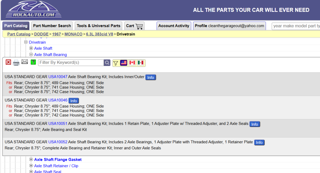

The problem with Rock Auto and many others is the listings aren't as complete as they should be. I looked up '67 Monaco (IIRC) and here's a screen shot.
No Timkin bearing listed. Yet we know that there's a Timkin bearing set that fits and RA does carry it. I did a little more searching and I even found that they don't even list a rear axle bearing for a '67 300! Yet they list them for a '67 New Yorker, which we know has the same rear and pretty much the same car.

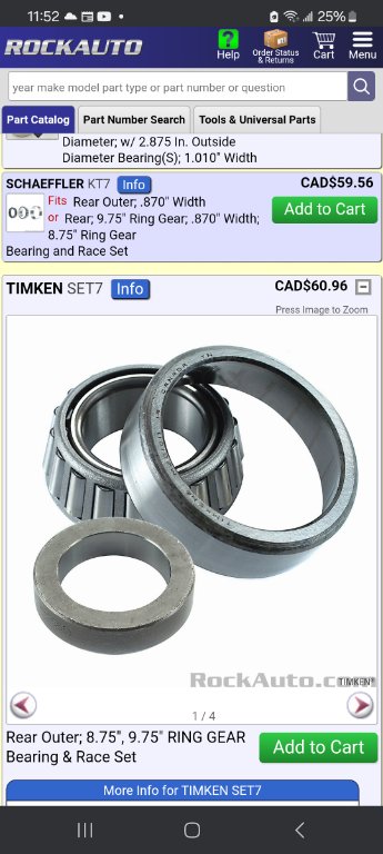

How did you search? In the part-number search yea I can plug in "set7" and see the timken show up, but how do you search for bearings based on size or based on axle (8.75) ?

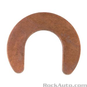

What about this part (axle shaft retainer / clip) MOTIVE GEAR 3833322:
Where does it go? No kits as far as I can tell contain it.

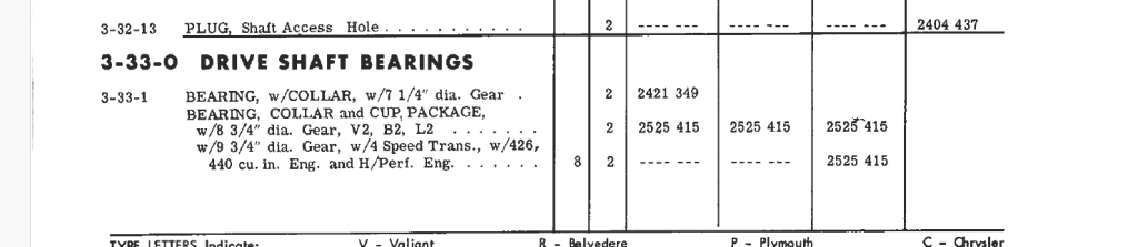

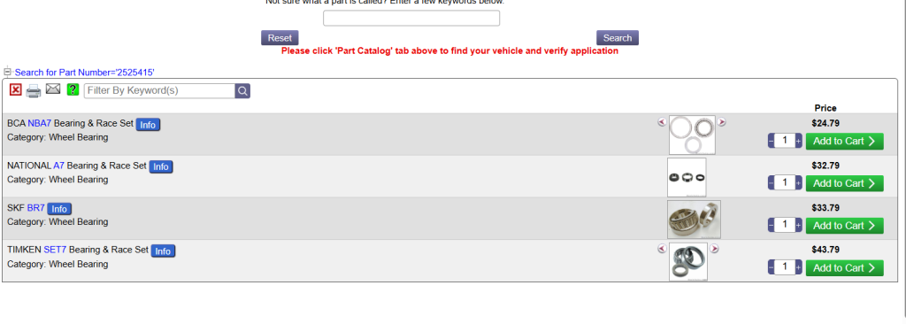

Type in the Chrysler part number. In this case 2525415 and it will cross to the SET7.
Take it one more step and hit the "Info" button and it will open up to another page and you'll see that Chrysler part number. (Yea, I know it says "driveshaft". Chrysler calls axles driveshafts)

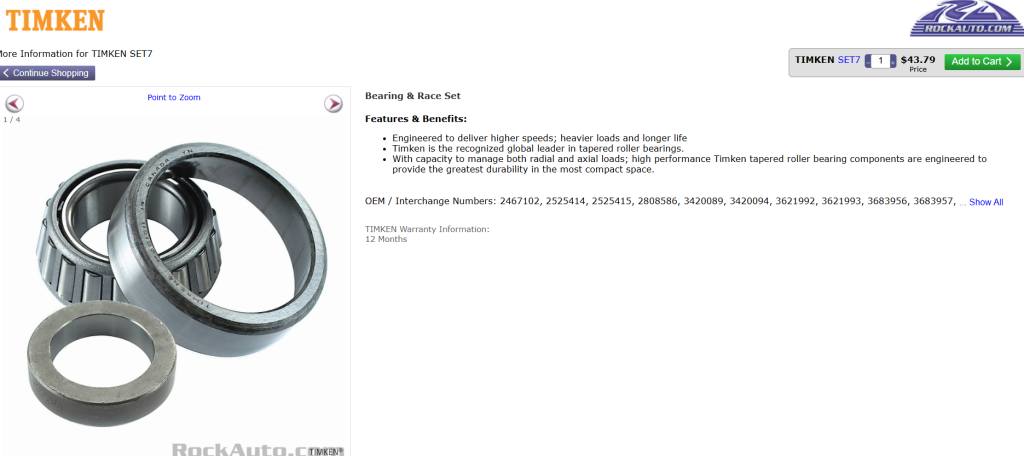

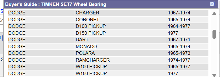

What's funny is if you click on the SET7 number in the RA listing, it comes up with "67 Monaco". Why this doesn't cross back to the application listing doesn't make any sense.
Yes I tried looking through several different C-body cars and years and they just showed the US Standard Gear offerings. But it seems when you look up the bearings by part number, these are the total offerings by rock:
BCA NBA7 Bearing & Race Set $34
NATIONAL A7 Bearing & Race Set $45
SKF BR7 $47
TIMKEN SET7 $61
They are all listed under catagory "Wheel Bearing".

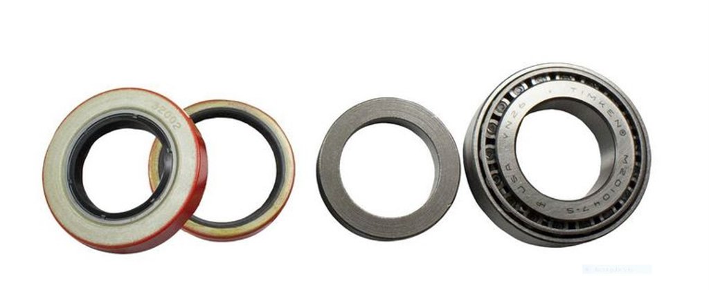

I would love it if they made this type of bearing and it fit in the axle:
that Motive Gear C clip is not used in an 8 3/4 rear...in an 8 3/4 the bearing is pressed onto the axle shaft...those clips are used in the rears where you pull the rear end cover ,remove a pin and the clip goes into a groove cut around the end of the axle to hold the axle into the side gear of the diff...lot of fords and chevys use that style of axle retention and I believe an 8 1/4 Mopar does too...idk about Danas...
