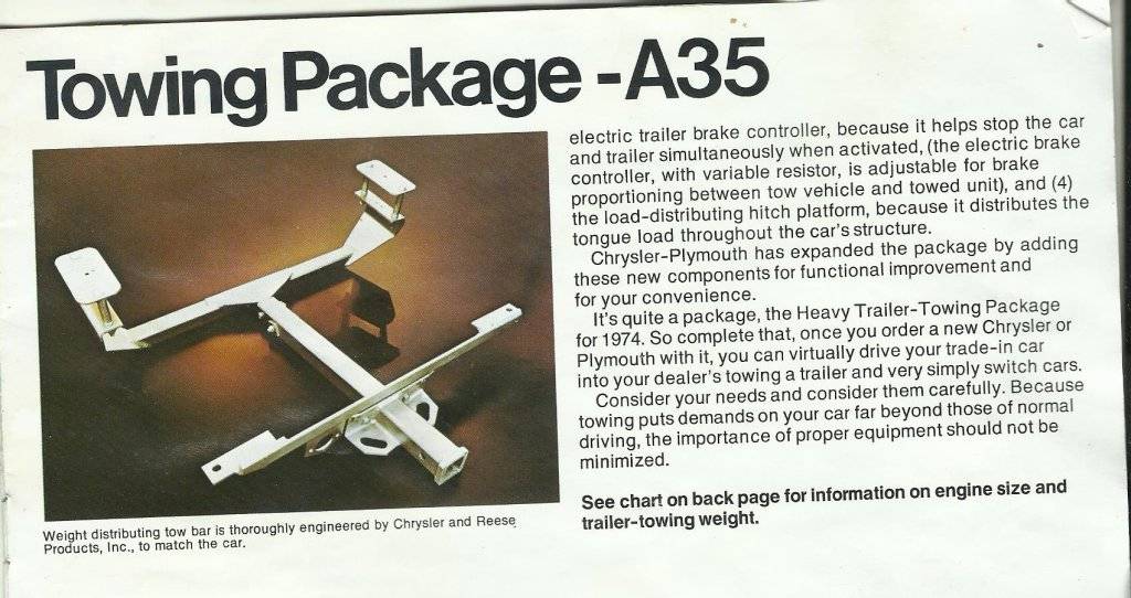

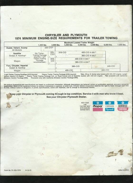

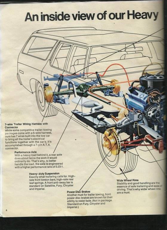

i scanned this on my home scanner/copier & fax machine this s th 1974 towing guide
