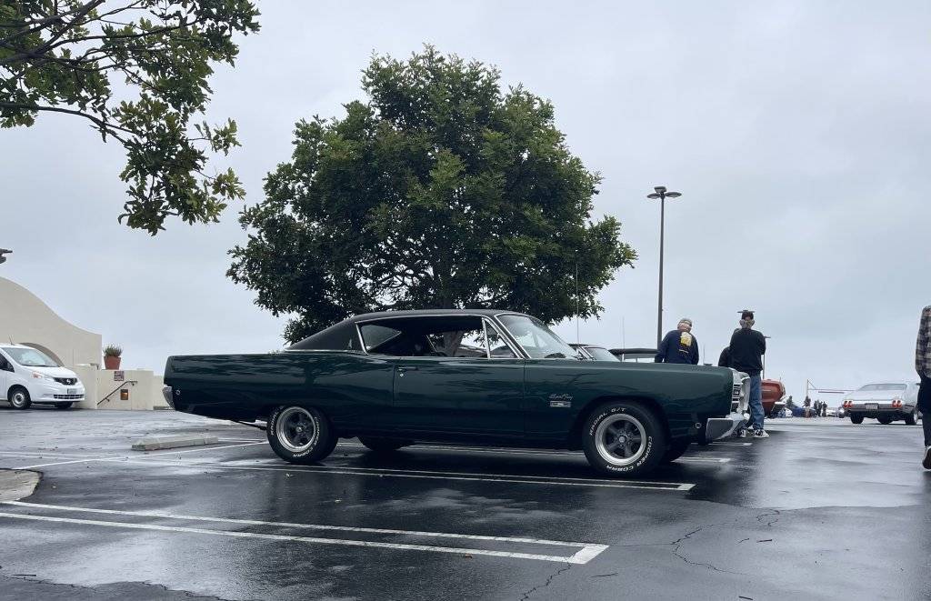

I guess I’ll start with having a look under the car and take a good look at the shock mounts. I think I’m ok, my car is not raked up to the sky but has been slightly lifted about 2-3 inches.
It’s just my preference, but after I check it out I may just put the standard gas shocks and rebuild my leaf springs .
Here’s a side view it don’t look too raked.
I’m also getting aquanted with the car and slowly discovering things.
But overall good so far.
