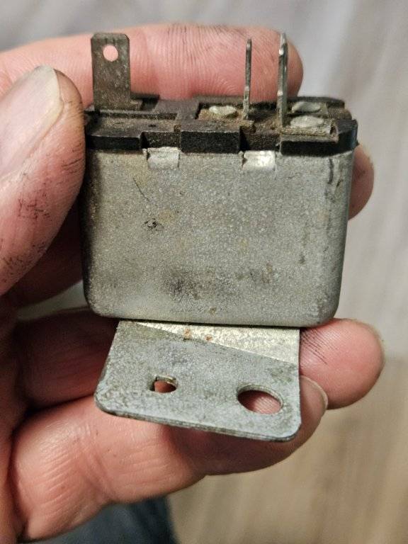

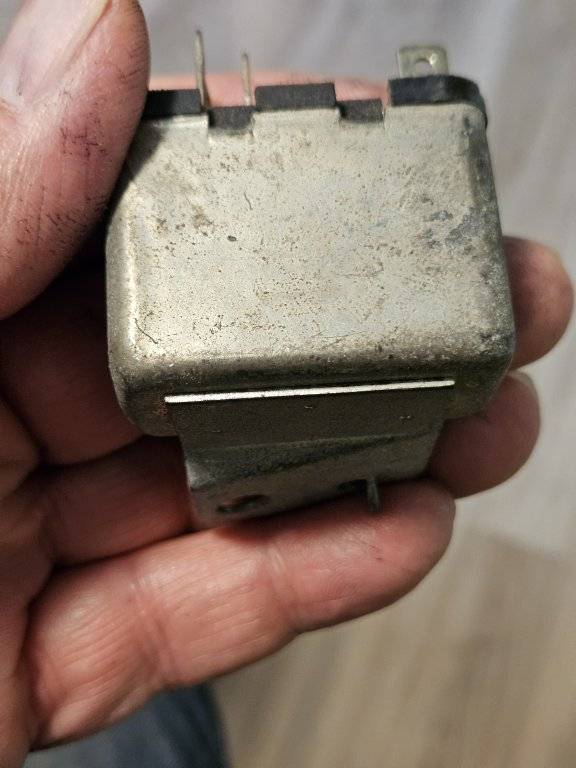

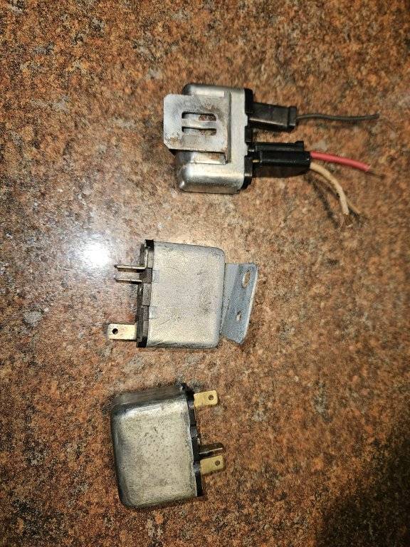

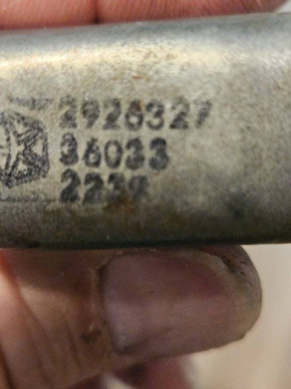

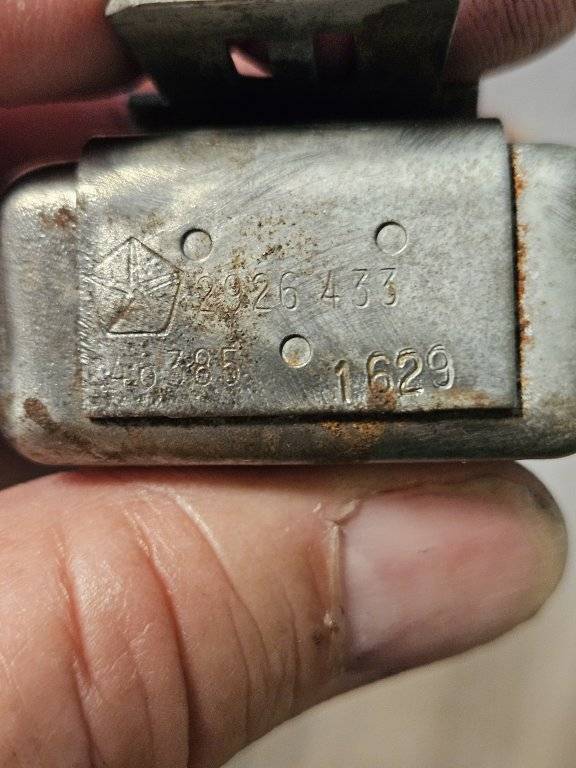

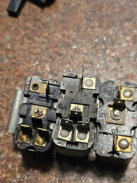

I have 3 relays: 1) chrysler part no. 2926433, 2) chrysler part no. 2926327, 3) no part number. Where are these used?
The unmarked relay appears to be a GM high speed fan relay. Similar to the power window relay in construction.
2926327 is a horn relay of the style that plugs into the fuse blocks that started in 1970 on some models.
2926433 is a window lift relay that slides onto the fuse blocks, that started in 1970 on some models, with the attached bracket.
This is a combination horn relay and key in switch buzzer, part number 3579205, for 1971-1973 A-bodies. It mounts to the inner A-pillar above the kick panel.
