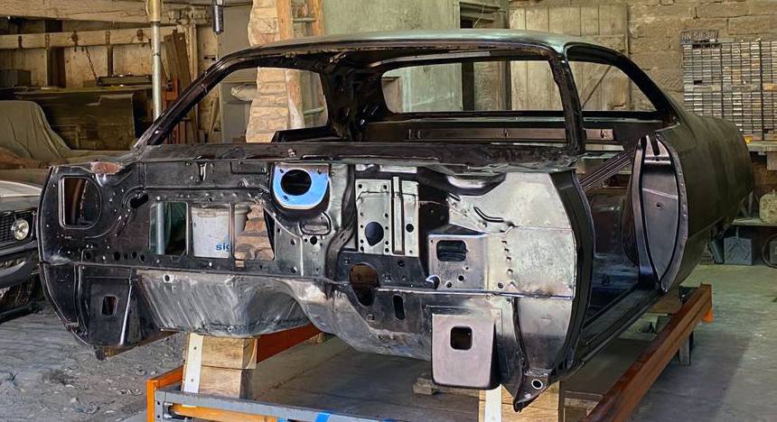

I'm not tied to seasons ;)
Changing the bolt pattern now wouldn't be a problem if it would solve the booster supply issues for the future, but if there are other things different as well, that's not an option.

Why worry about cost at this point? You are definitely pregnant and you need to have the baby!
Well it looks like your car will be down for awhile and you won't be driving her anytime soon. File away if you want and make something else work but we are just giving you our opinions. Good luck.
