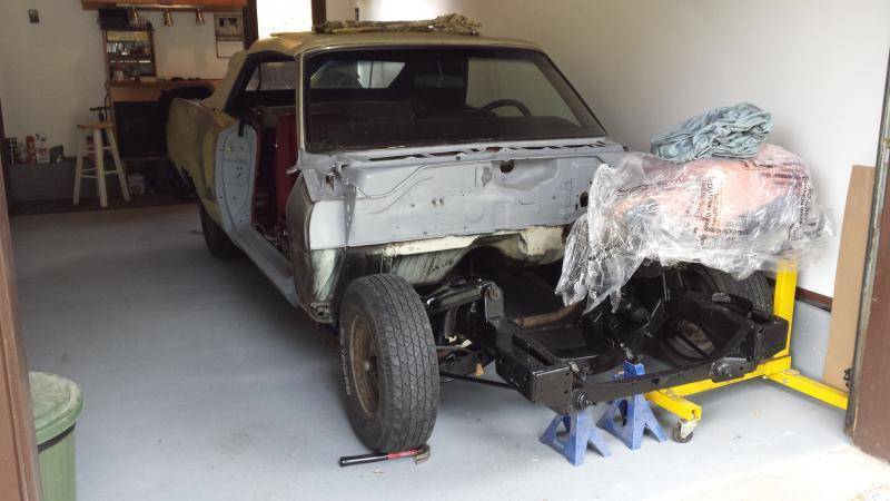

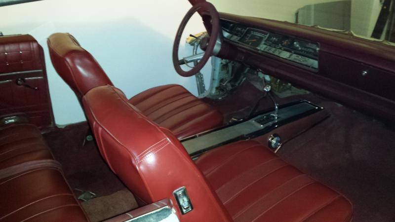

It's his Dad's convertible that he's restoring for him before his dad kicks off. This picture here is obviously the interior.
This was supposed be a quick scuff and paint of all the new panels. The car was still a cruise night runner....instead my brother started a nut and bolt resto.THREW AWAY!!!!The numbers match 318 that ran fine and kept a redone early 70 motor 318. I recently took it back to finish 68 sport fury since I brought it across the country 13 years agoJoe's Phone Pictures 017.jpg

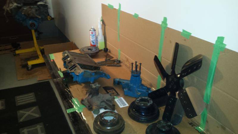

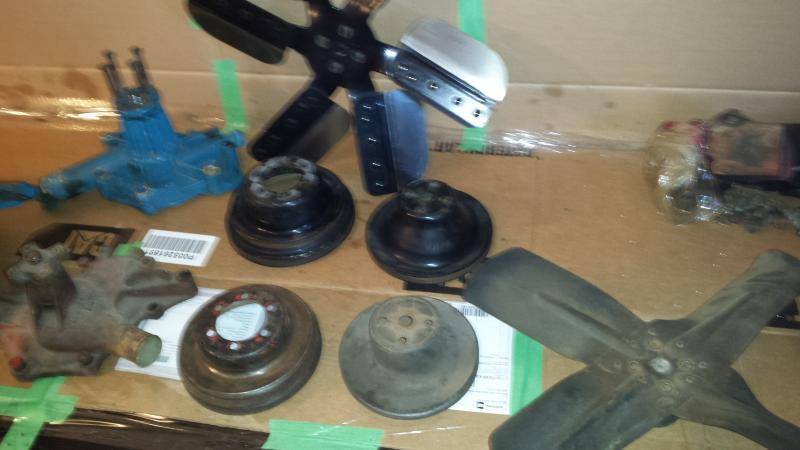

Intake specs and sequence for torq down would be appreciated...it,s a 75 318cast. Ran into a snag with my pulleys. The 68 set wont line up on balancer and I,m thinking if I use the 75 set it throws my p.s belt alignment off. New 68 water pump ..pretty crappy pic but you can see 68 set up in on row and 75 in the other..,all measure different.021.jpg020.jpg
You just need to find an earlier balancer or just elongate the one hole that is off.
All the 68 stuff should fit on the 75 engine, you will probably need to run the earlier water pump.
Alan
I've cheated and moved (properly, with a press) water pump pulley flanges to make things fit. They can also be shimmed a bit with a spacer. Shhhh. It's our little secret.
- Dylan's dad
Thanks for the advice....I solved things by dremel tool to last bolt hole in bottom pulley, one bolt hole was off by half a hole, everything lines up now. thanks again the willingness to help is great on this forum
