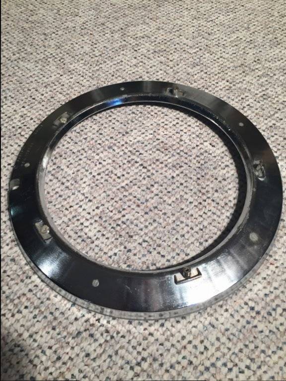

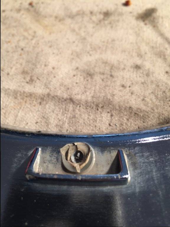

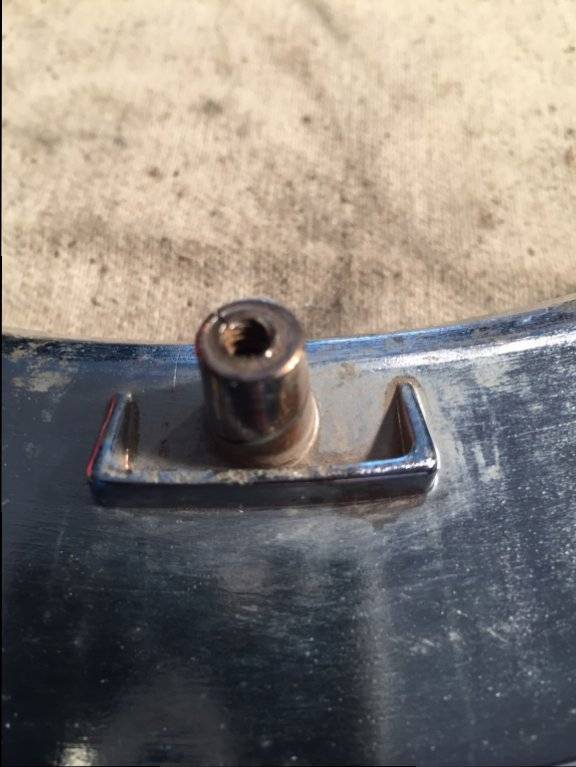

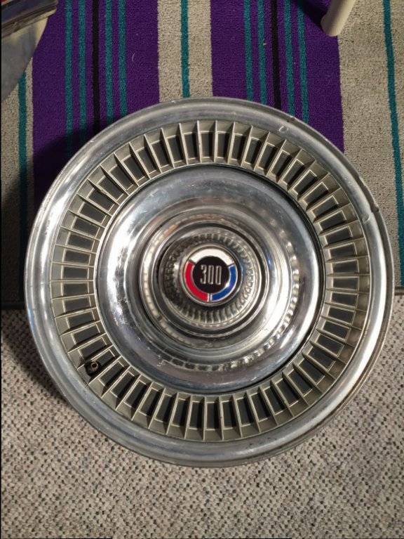

I'm cleaning up some Aluminum 15" Cordoba wheels and I'm having a problem deciding how to repair these broken mounting studs. 2 of the 5 are snapped off. As it is a plastic stud who has a good fix out there??

Thinking about it, since this is going to be more stressed, that option is probably not going to work.
There's a few different methods. One thing that comes to mind is to do some plastic welding. You use a hot air gun and "weld" a new post on. I've done a little of it and it sounds a lot easier than it is. Another way would be to grind it all back and epoxy a new post on. That would be a better option. You'd have to use a good quality epoxy, maybe some of the stuff they use to repair bumpers might work.
I think the ultimate repair would be to just drill through the trim ring. Countersink for a nice 100° oval head stainless screw and put some sort of standoff on the other side that you could bolt to. I'd cut all the posts off at that point. You'd need a special countersinking tool, but the 100° screws are available as interior screws. If done right, they wouldn't be noticeable... or at least might look "factory". If the hole is opposite one of the "fins", you could "clock" it slightly one way or the other to hide the screw a little better.
Would you be able to carefully drill down where the stud was without going through, tap (thread) the hole and epoxy a nylon or steel stud the appropriate length in place? Not familiar with those.
If your not planning on ever removing it from the stainless wheel cover again, just glue it in place onto the wheel cover with RTV, or jb weld
