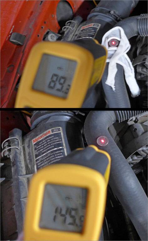

This means an infrared thermometer probably will not be able to accurately measure the temperature of a very small, isolated area like a spark plug's terminal or a bolt head. I sat a dime on top of a hot radiator hose (see photo) and surrounded the dime with strips of damp rag. The thermometer measured ~89 F. Without the rag pieces, the thermometer measured ~145 F. The laser beam was centered on the dime, but the thermometer was measuring the temperature of a larger circle/spot surrounding the dime. The temperature dropped if the cool rags were in the spot.
