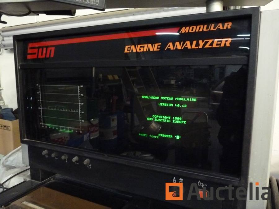

Honestly I think it runs fine. It was rebuilt a few years ago. I was told by him though, and he used to be a manager at ammco transmission in the 80s.The best way to check it is to have it tested on an engine analyzer. Finding a shop with one is tough to do these days.

Not even sure if it is right, I was told by someone that it sounded like 7An ignition scope would let you watch each cylinder's plug firing traces. Many of those will allow you to kill cylinders in succession. Then you can watch the tach to see how the rpm drops or doesn't drop as each one is shorted.
