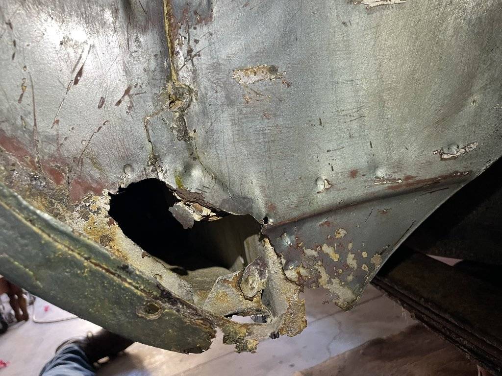

Results after weeks of treatment inside the rockers.... some areas were completely eroded away that were entirely held together with rust.

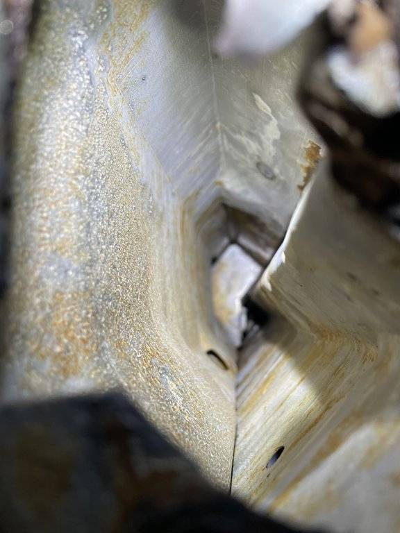

Inside the rocker panels - they came out clean!

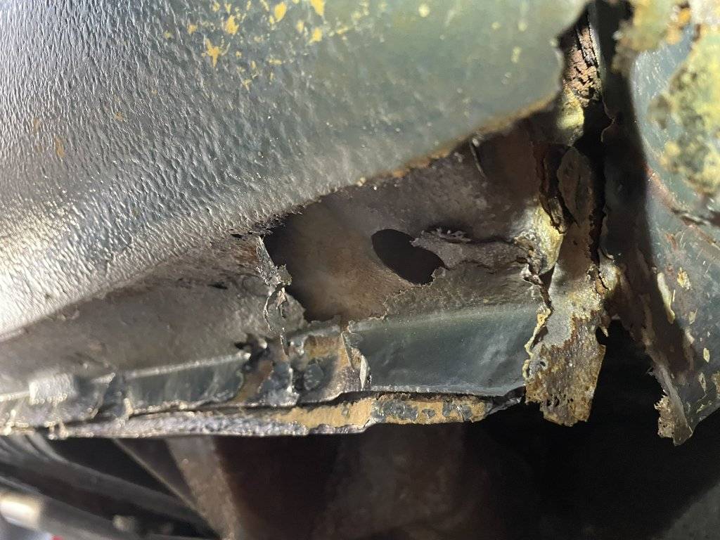

Bottom rear of the rocker. After cleaning it is evident that rust has pushed apart the pinch seam at the bottom of the rocker. Also the outer panel is completely rotted away. This area not only gets splash up from the road but water draining down from the quarter window above. Will need repairs....

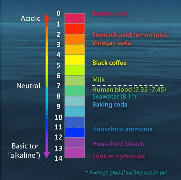

A PH of 4 just means you created a mildly acidic solution.
Any acidic solution will dissolve rust. The only difference is how fast. Since acid will also dissolve unrusted metal, you want to find something that will remove the rust with minimum damage to the good metal. I image that the particular steps are to buffer the solution. A good explanation may be found at:
