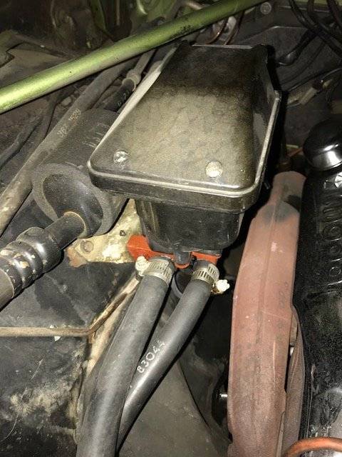

Help! New to this forum, and on the search for a 'water valve for the Auto Temp 2 system'. That's what I'm told this is...any suggestions on where to track one down? It's for my 73 New Yorker Brougham - been in the family since brand new.

Great tip. Unfortunately that gent is on holidays for a bit. What are the consequences of removing the unit temporarily while I wait for the replacement to arrive, by simply reconnecting the hoses with an insert to bridge the gap?

That would not affect anything and you would avoid losing any coolant while you are waiting. You just would not have any heating/cooling of course unless you bypass the system temporarily.

Don't ask me how I know, but the heat will work, (no shutting it off without installing some kind of valve) however you don't have to run the blower. Or you could loop it. If you have some half inch copper pipe you can use that to connect the two pieces of 5/8's heater hose. You'll need a 5/8's to 1/2 inch adapter for the return line. Also you'll be safe running straight water until the mercury starts dropping, another few months. While you're waiting for your new part, which they don't give away, around 600
USD, plus exchange. Worth it and not really any other option without hack modding it. Apologies for the dual post. Was just about done and the thing started glitching up on me.
