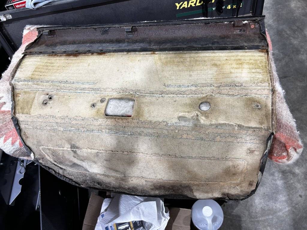

One of the door panels (passenger side rear), has a good portion of the fiber board (Masonite) that got wet.
I am planning on replacing it with masonite of similar thickness, UNLESS you all have a different solution.
Suggestions welcomed!

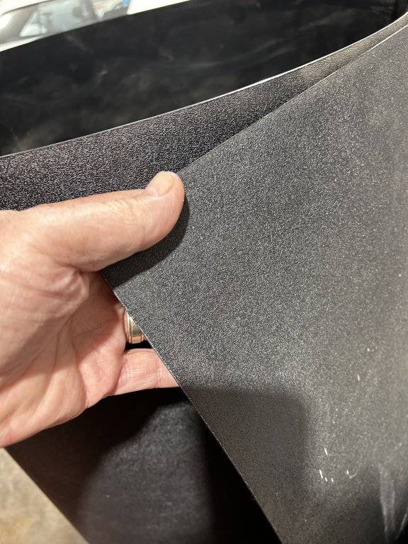

I have a 4’ x 8’ sheet of 0.060” black abs plastic that was leftover from me replacing the exterior floor of my RV. I think that I will explore your suggestions and see how it turns out.

I’m going to use some.060” black abs plastic (2 layers sandwiched together with 3M contact adhesive). I’m thinking about how to attach it to the metal top as it has metal prongs that bit into the fiberboard.

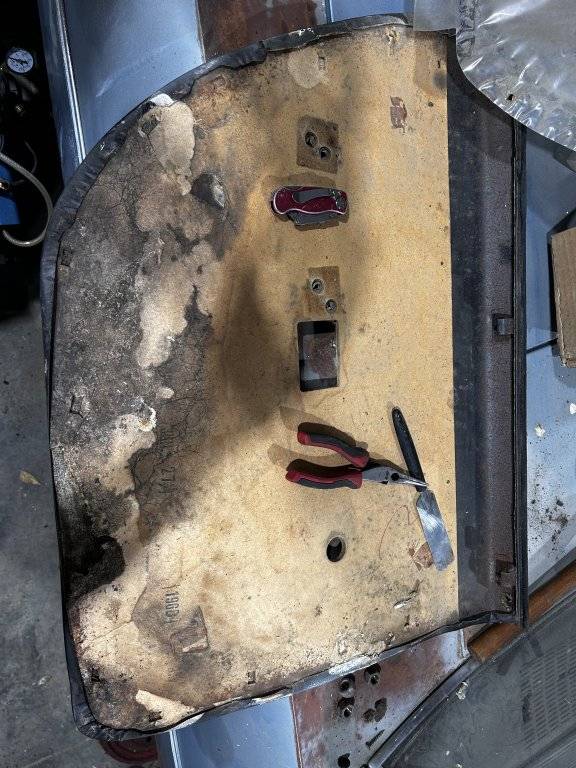

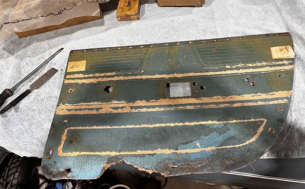

I got the vinyl separated from the door card. You can see the damage on the bottom, due to water.

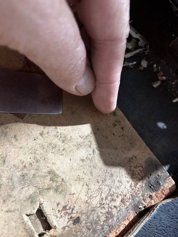

I used a putty knife and a large straight slot screwdriver to separate the door card from the top metal piece.
Now to cut the abs plastic and start making the holes in it. I will cut out two pieces and glue them together first and then make the clip and pass thru holes.
