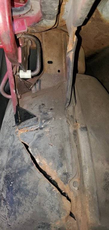

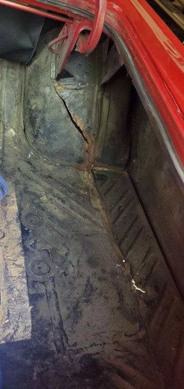

Hoping some of you folks could point me in a good direction on how to fix a big tear in the rear inner wheel well and trunk floor on my '68 300 Convertible. Looks like a blowout maybe caused the damage. Pictures attached show the splits in the passenger side rear wheel well.
How would you go about repairing this?

The tread peeled off the tire one night on the way home . A buddy met up with me at 11:30 at night with his car trailer . We got it back in place , but never got time to weld it up . I put new tires all the way around that weekend .
Hap .
For a good weld, might clean the area along the split really good so the weld bites well. Then reapply undercoat to the fixed areas in the wheel well and paint to the inside of the trunk.

That must have been some blowout! What does the underside look like? How long has it been like that? I'd be worried that body flex will make it worse. As said above, it is a fairly easy repair, hammer and dolly, then weld the seem shut, grind, paint undercoat.

@Samplingman - Hap commented above on what caused it, apparently happened when he was the owner of the car, but not sure when that was. If the tires I replaced are any indication, date coded over 20 years ago, that would suggest it's been like this for some time. The body flex is my concern as well cause I love the throttle!
I have a friend who has been welding for over 60 years, this will be a good opportunity for him to learn me up.

I wanna say this happened in 99 or 2000 . I sold the car in 2017 . I always had intentions to weld it up , but I'm not that skilled at welding and I could never get it in to someone who was . I felt sick to my stomach when it happened . I was sure I took the quarter off . Pulled the car off the freeway and looked under it . The tread was wrapped around the rear axle and the wheel house was shoved into the still inflated tire.

Sure enough, that fragging tire busted the rear fender well open! I later beat the sheetmetal down, used some sheet aluminum to close up the gap left by irretrievably bent rusty steel, and used the aluminum, fiberglass cloth, roof repair resin, and aerosol caulking foam to close the fender. Our candidate didn't get into the Blight House that night either, but we got paid well, and I got some nice bonus $$ also.
