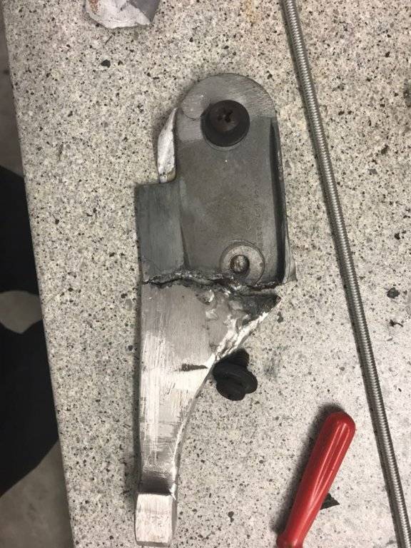

i having a bad time trying to restore my power windows on my 1971 300. It all started with my front window falling down into the door, i repaired that and after a week this "metal stop thing on the window" broke!
Does anyone know where i can get this thing?

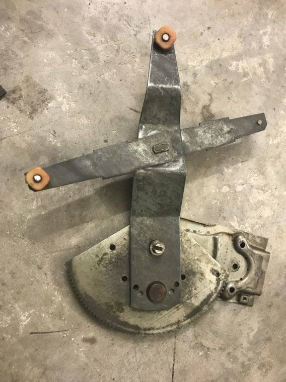

But thats not all! some days later my rear window on the driver side stop working... so i pulled the whole window regulator assembly... to be honest, that took me about 3 hours and i was freaking out because that damn think just would come out!!!
when i finally got it out i noticed that the spring was missing... and i also wonder why there wasn't anything to hold the spring. is this normal? or do i need a new regulator?

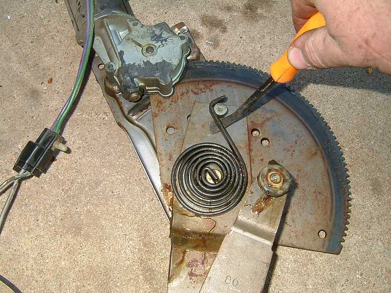

Your regulator appears to be missing the anchor pin for the spring... I grabbed a random internet picture to help illustrate what is missing...
Yours
Since you have the door apart as well, you might be able to see the pin the spring tensions on, the back is often similar, but not always.
Depending on what you find, and if the missing piece is inside the 1/4 panel... you should be able to make an effective repair. Otherwise, I second the Murray Park idea... and without painful fabrication efforts, he is likely the only commercial source for the front door up stop.
