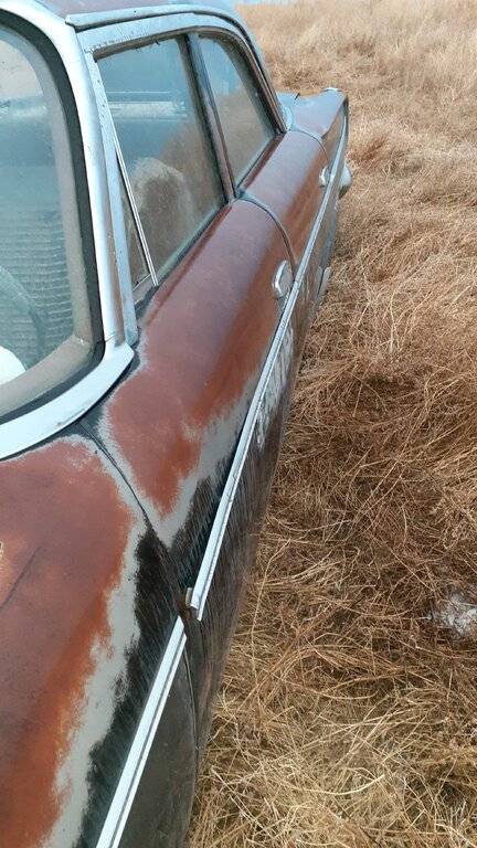

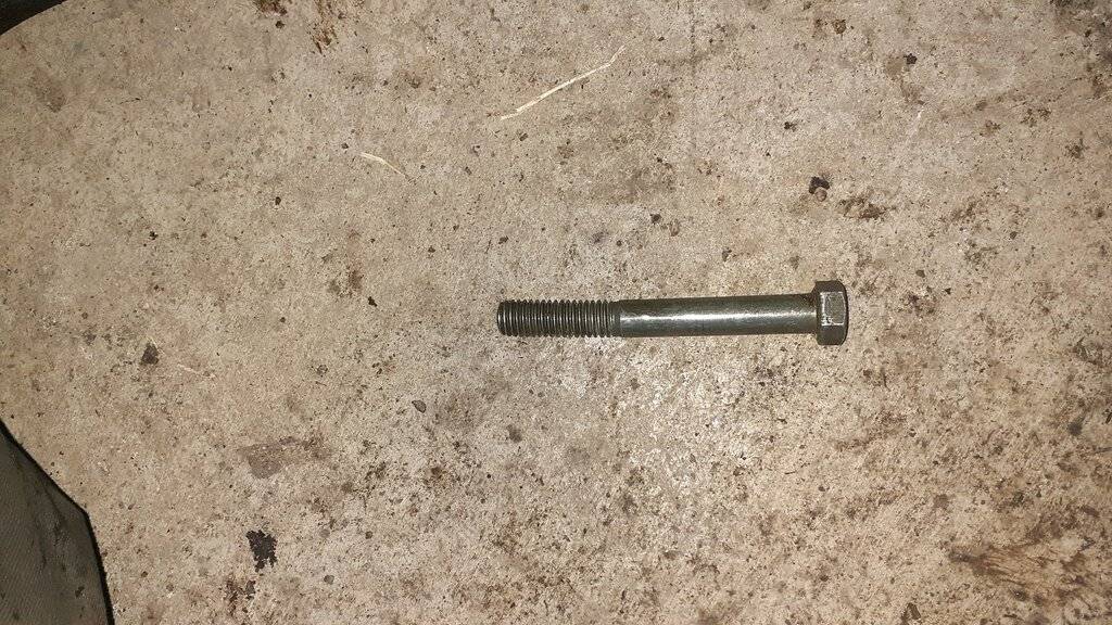

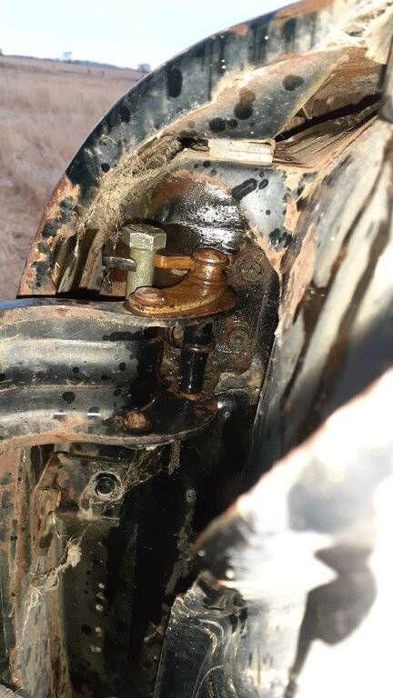

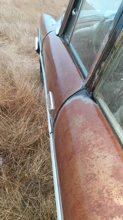

Anyhow the Saratoga had sprung drivers door so I went out and used my buddies plan on it. You can see how it was before and after. Took all of 5 minutes. If you look close you will see the 7/16 bolt. It goes in the U shape notches that the roller fits in to hold the door open.
With the bolt in the U notches I forced the door further open. I give it a steady push. Then closed the door enough to get the bolt out and closed the door to check for progress. It was coming but needed more so I put bolt back in and pushed the door open again. On the 4 th go round I got a door fitting real nice.

Good and creative repair, what is that growing on the inside of the fender?
Dave
Dave, I laid the penetrating oil on real heavy before I started.
