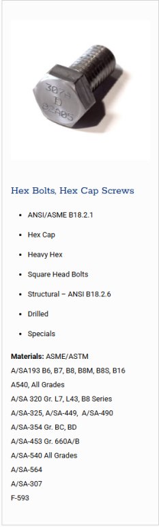

Stainless Steel? Depends if you want Nuclear Grade Stainless or Chinese Grade Stainless, there is a difference and I would suspect Home Depot would be Chinese Grade.
08-12-25.Fasteners – DuBose National Energy Services, Inc.www.dubosenes.com.jpg

Everything I've read says that SS fasteners from a box store like Home Depot are going to be sub-par. Usually too soft with no rating. They would probably work for the pipe flange as that's not really stressed that much. For the manifold, I would want to go to a specialty fastener vendor.
