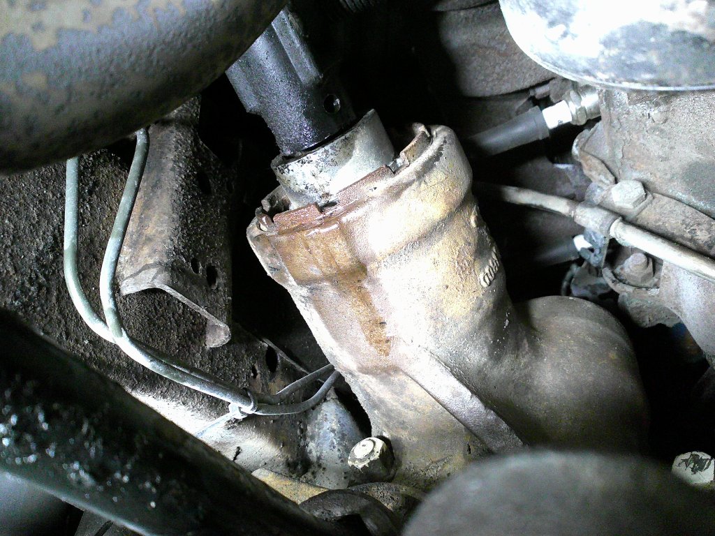

Hello gents. In my travels today in the 67 Newport Custom, I began to smell a strange smell. It turns out it was power steering fluid. I put the car on the lift when I got home, and it looks like there's a blown seal in the steering box. What's the fix? Do I have to remove the box and have it rebuilt, or can I replace the seal myself?

Thanks for the reply SIPLOWGUY. I do not know what the sector shaft is. I gave the unit a cursory look when I got home, and now I'm even wondering if there's a hole in one of the hoses. I'll take a closer look tomorrow.
The sector (pitman) shaft is where the pitman arm attaches. Common place to leak, box R&R is not necessary.

Perform step 2 first, step 1 and 5 may not be necessary. I would THOUROGHLY clean the area and pinpoint the leak. Do use care as I have heard of fires if the PS fluid hits the exhaust manifold.

More likely it's a hose if it's leaking that much. Seals usually, but not always, tend to seep rather than dump fluid.
Agreed, there's a good chance you do not need to remove the box to fix the leak. Clean everything to pinpoint the leak. It sounds like it's leaking bad enough that it shouldn't be hard to pinpoint. If it's the hoses, clamps, o-rings on the top, or seal on the bottom, it likely can be fixed in-car.
I'm also suspecting it could be a hose. Are you using Chrysler power steering fluid or generic automatic trans fluid? I noticed the pressure hose on my '67 Newport seeping red atf. I refilled the reservoir with GM PSF (which looks like the old Chrysler PSF), and the seeping stopped. Viscosity in psf and atf might be similar, but the additive packages and intended uses are different.
Later, the pressure hose popped so I cut the belt and drove the car to my shadetree shop, where it was fixed with a new Chrysler hose and GM psf.
