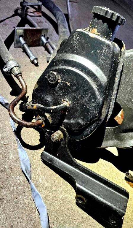

Quit messing around with the bottle and connect the hoses to the pump. Read this about filling, note the "air bind" comment. Suggestions for Filling Your Power Steering System — Powersteering.com

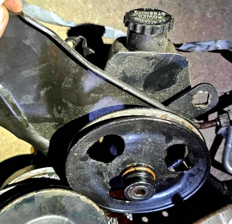

You haven't mentioned what type of pump you have.
