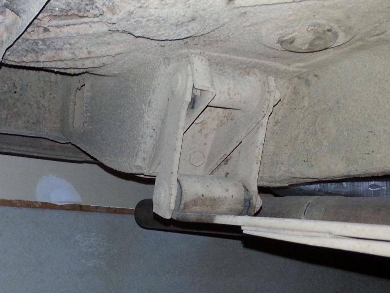

Here is a photo of one of the current shackles... it looks stock compared to diagrams in the service manual and parts book, but I'd like to find some confirmation if I could. And if I need to buy that set from Jason, I'd like to get moving on it... what do you guys think?
triple agreement on this one. I just bought a set from springs n' things they look just like these ones pictured above only clean... and new.....:icon_lol:
I agree you have the correct ones. I measured my good used ones there 5 3/8 also.
Jason, thanks a million for measuring them, it's great to have that confirmation. Thanks to everyone for weighing in based on experience as well. Good illustration of what a great resource this site is!
