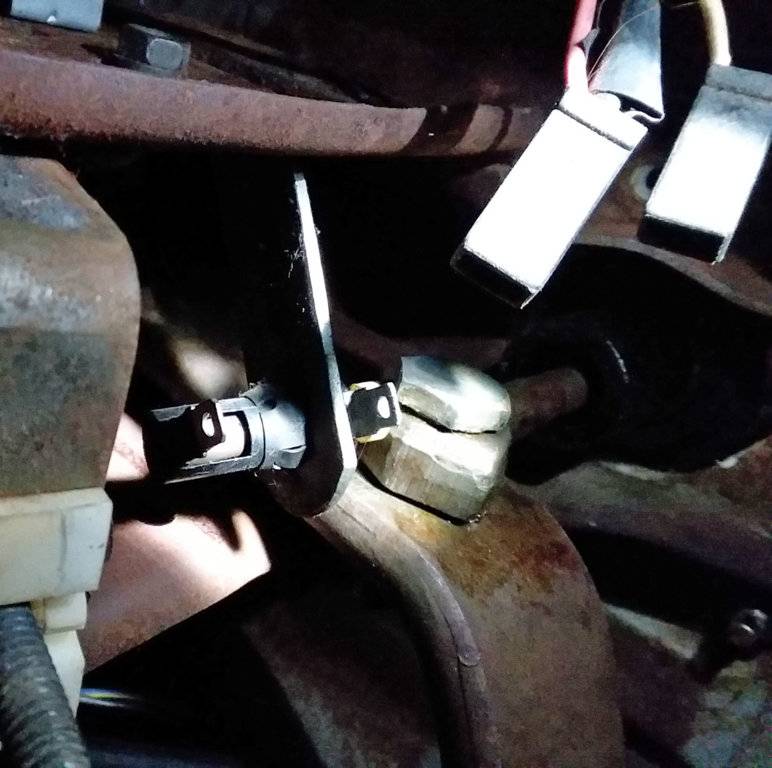

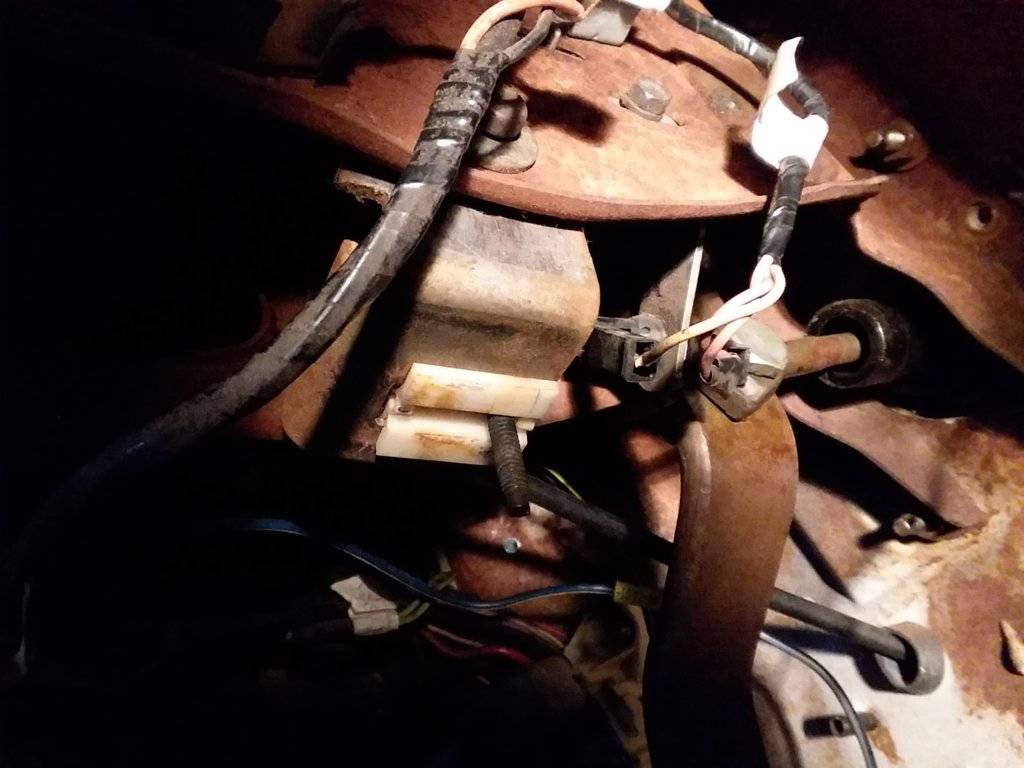

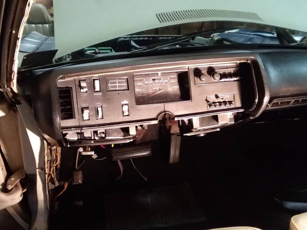

Putting dash back in my 1970 Fury III. Can't remember which wire goes on which spade. The 2 pink wire connector includes power from the fuse box. I believe the white wire goes back to the taillamps thru the turn signal switch. Please clue me in so I don't reverse wire the switch. Standard dash, power brakes. Thanks!

The pink wire is your hot one. Do yourself a favor and get a hydraulic switch from Painless Wiring, thread it on to your brake lines and be happy. This works very nicely. You can extend the switch leg, (white wire) through the firewall and use whichever hot source you care to.
I just installed the white wire on the mobile spade and the hot wore to the front spade. The stop lamps work fine. If I have problems, maybe I'll install a switch on the brake line. Thanks for the advice though.
