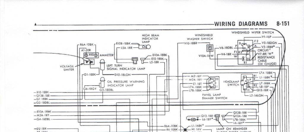

Hi Dave. I pulled my dash and I believe my 1970 Fury is full load.

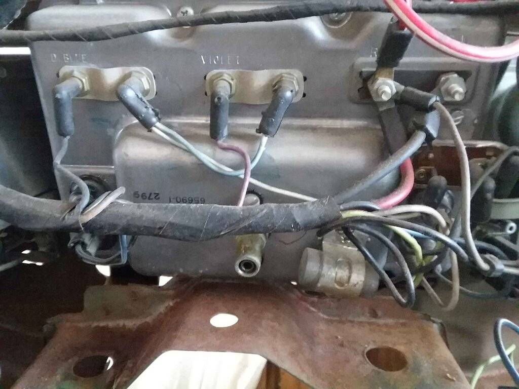

Front view
Rear view before disassemble
