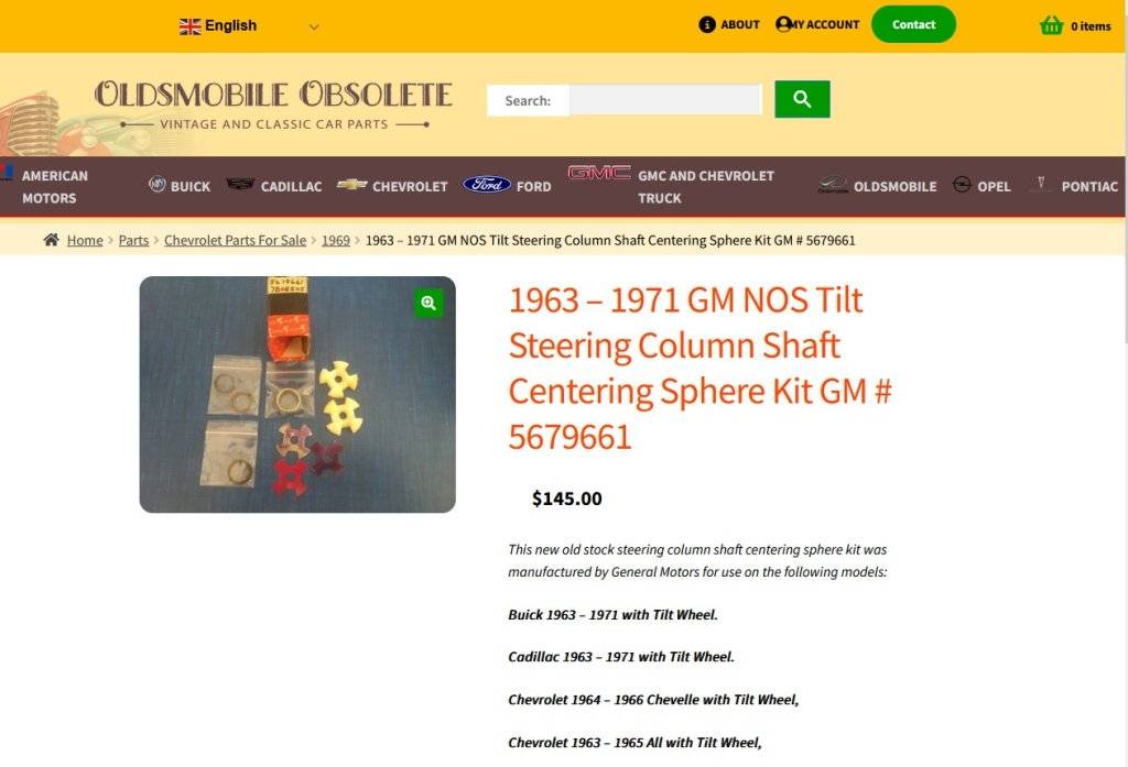

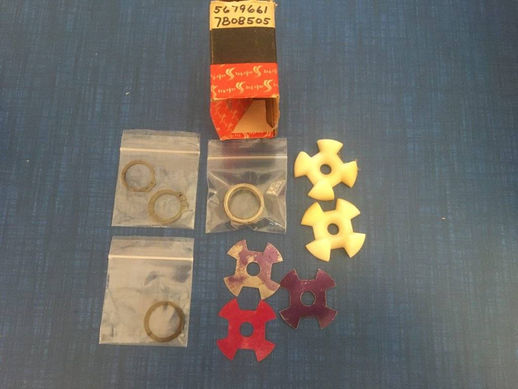

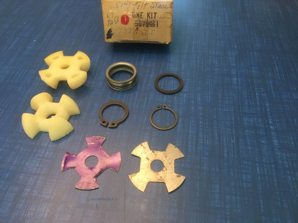

It turns out that I did have my coworker order the repair kit, so I was able to have him find it for me on his ebay account. Checking google and ebay, there aren't any kits currently available. I'm going to guess that Orange County Columns probably has some shims that they can use to get the bearing preload where it needs to be.
Here's the kit:
Jeff
