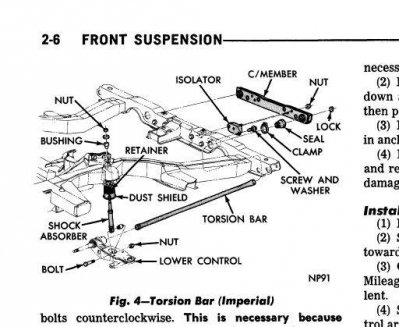

Here's a grab from the FSM. Are there any other parts that should be suspect?
Note that I'm not getting into the whole front end. That's a project for another day. I'm just removing the C-Member so I can replace the Isolators, which have been rebuilt. Basically, do I need to be inspecting the screw, clamp, seal, lock and nut before I get there?
