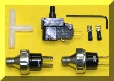

Figure out a way to control OD/LU 100$ (ish)

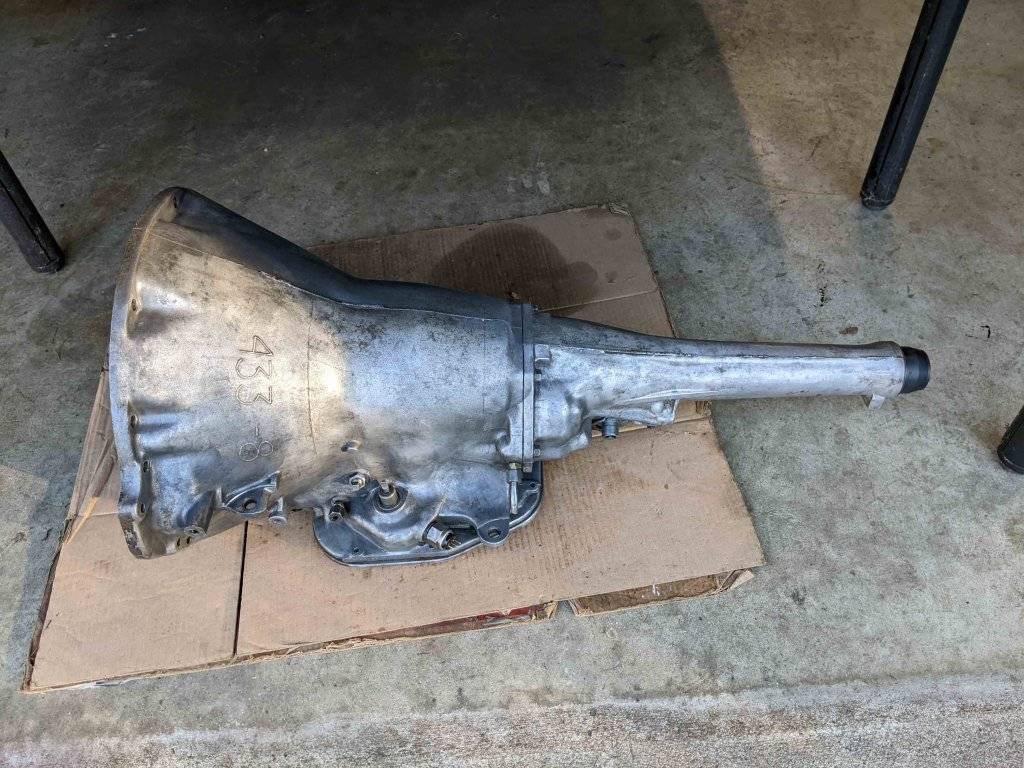

Example
We're not bolting it onto my 1971 727
Fits all 727 or 518 transmissions. IT IS NOT JUST A BOLT ON! If you look at the casting line on the 727 in the photograph ( above the 433 - 8) you can see the general area where the housing must be cut to allow the Ultra-Bell to mate to the case it then can be bolted on using the front pump bolts. Check out FABO/FBBO websites there are some pictorials over there IIRC.

BTW there has been some discussion regarding the loss of mounting location for factory shifters, both column and floor. DO NOT throw away the bell you cut off, the factory mounting can be tig welded to the ultra-bell to facilitate factory mounting position. It is helpful to take photos and measurements before you cut. These can then be used to correctly position the proper mounting points.
