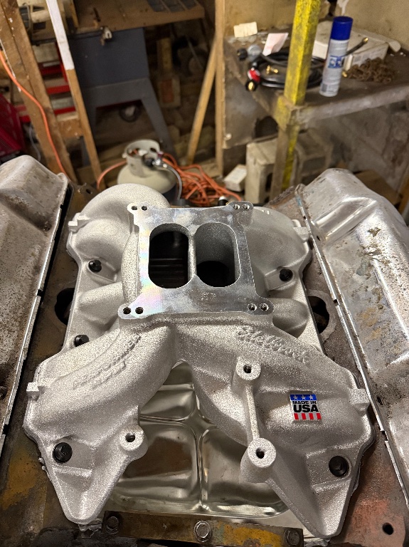

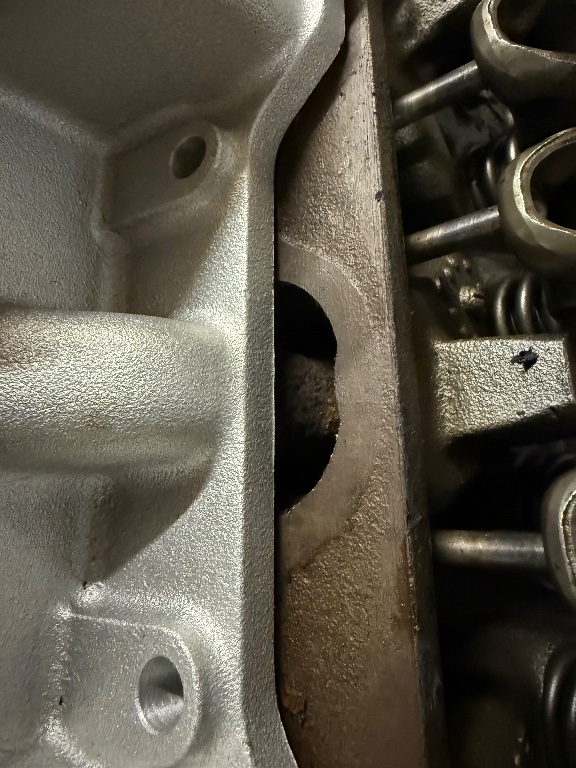

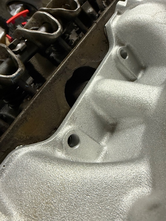

Jan 6, 2026 #1 SludgeWizard Member Joined Oct 25, 2025 Messages 63 Reaction score 28 Location Rhode Island, USA Hey y’all, I’m test fitting an edelbrock performer 7193 on my new (to me) 440. It’s a 73. There’s these two open ports that the intake doesn’t cover, seems wrong? Am I crazy? Missing something?
Jan 6, 2026 #2 Toolmanmike Moderator Staff member FCBO Gold Member Joined Oct 25, 2019 Messages 2,097 Reaction score 2,150 Location Iowa They are nothing. Just let heat out.
Jan 6, 2026 #3 Big_John Illegitimi non carborundum FCBO Gold Member Joined May 21, 2013 Messages 25,062 Reaction score 40,110 Location Marcellus, NY That's the way it should be.
Jan 6, 2026 #4 SludgeWizard Member Joined Oct 25, 2025 Messages 63 Reaction score 28 Location Rhode Island, USA Got it, thanks guys. Talk about lipstick on a pig lmao
Wednesday at 10:41 AM #5 V volksworld Well-Known Member Joined Apr 12, 2020 Messages 795 Reaction score 654 Location n.c. those cutouts allow airflow around the port that feeds exhaust under the intake manifold to pre heat it
