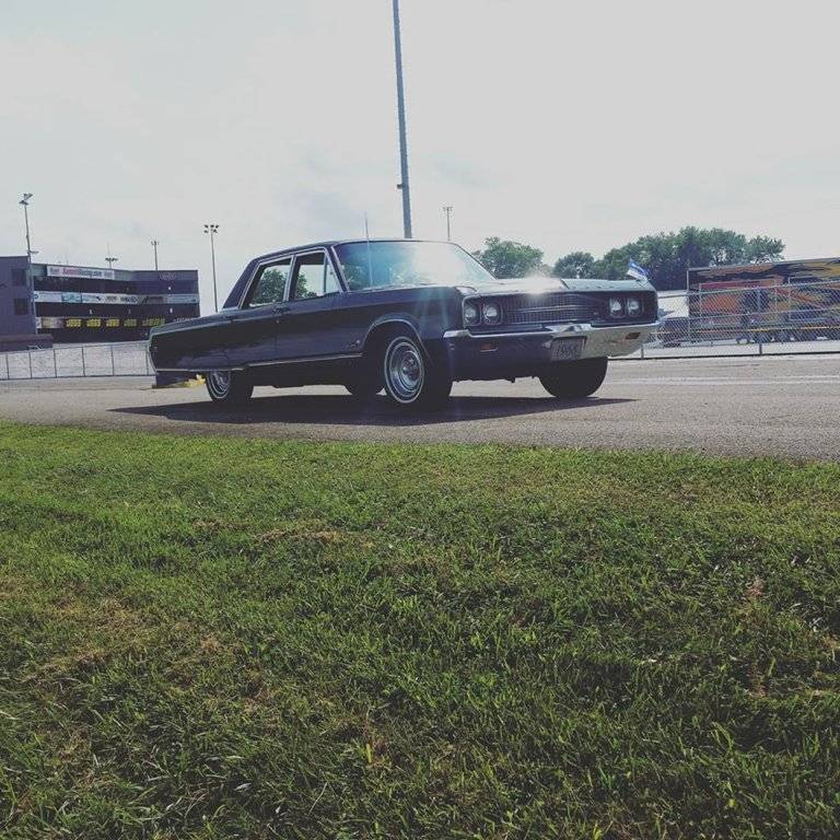

Well ive had my 68 New Yorker for about 5 years now and finally have the engine bay tore apart to fix some firewall rust. I figured while i was at it i might as well do some cheap upgrades to the engine. Its a low mile motor with about 20,000 miles and numbers matching. It has a rebuilt stock Holley 4bbl and stock manifolds. I wanted to see about maybe putting on a bigger carb or buying a carb package with two small edelbrocks with a dual quad manifold. But i figured if i would want to do any of this I would definitely have to do a cam swap. But would anyone recommend any good cams for this type of application. My goal is to make a little more power and add to the wow factor, the car already got upgraded with new magnaflow exhaust and 3.55 gears. I also got a Electronic ignition system that was new from the 80's. Would anyone recommend a good hydraulic cam that still wouldn't be to extreme and also a setup for a bigger carb or dual quads? Its a really clean body except for the engine bay, the car was covered most of its life until the past owners bought it and had the hood off of it to rob parts for his winnebago!!! So at that point the cowl had leaves and started to rot when it was put in wet storage for a year. But I want to make it run like a decent 440 and add to the wow factor a little bit if possible. Any suggestions would be appreciated!!!
