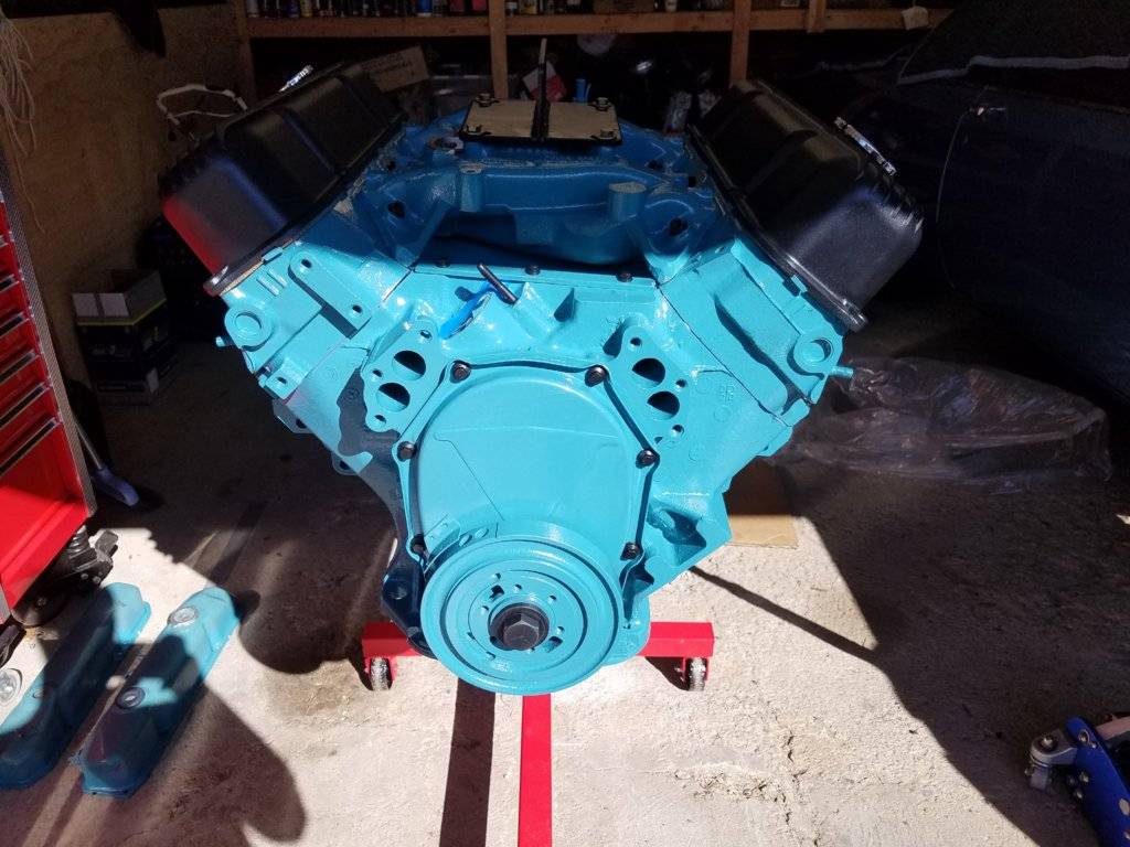

the machine shop I used reused the factory crank and rods. he installed some new pistons to bump compression up. He said he balanced the rotating assembly. Here's a pic of the balancer.
That is a T-Code balancer, you do not need a weighted convertor with this motor. Order a non weighted convertor. Did you also install a higher performance cam with the compression upgrade? You may need a higher stall speed convertor if this is the case. Check the stats for the cam and order the appropriate stall for the convertor.
