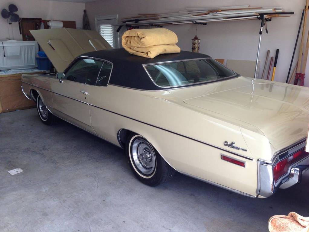

Does anyone have suggestions on how I can make vinyl trim inserts for the body side mouldings? I've pretty much given up on trying to locate NOS pieces.

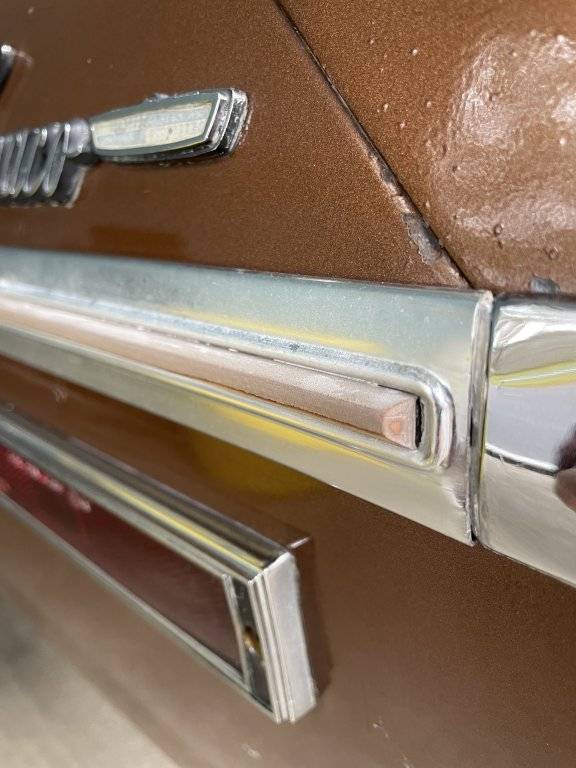

the prob might be that for 73 the trim strip thickens, not sure if the rubber thickens as well towards the rear.... so that might cause an issue
heres a 72 & 73

It will be hard to exactly-match the size and shape of the OEM vinyl insert, BUT under their chrome molding selection, there is one which is close, so the width of the OEM insert is important.
If there is a MAACO body shop nearby, you might check their selection of vinyl body side moldings. Or perhaps they can advise of a local jobber for such?
A key issue might be how the vinyl is attached to the aluminum molding body. Is it with "tape" or "bonded"?
