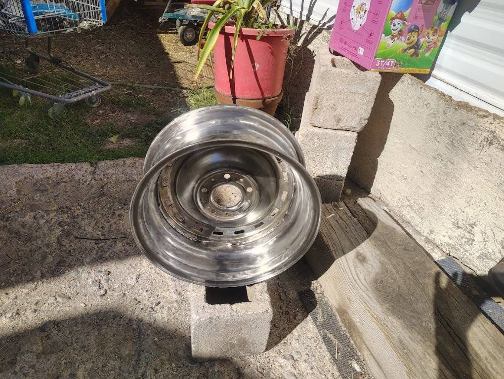

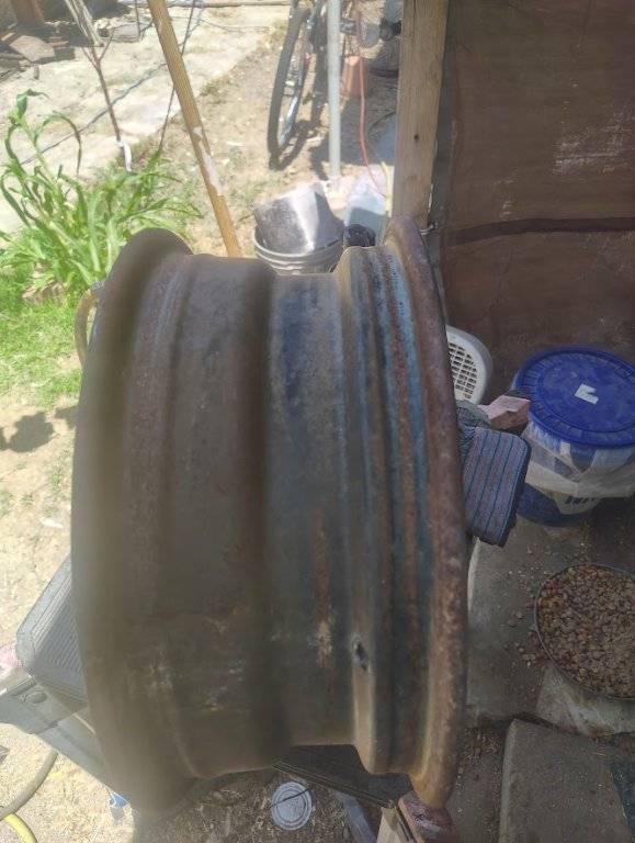

Autumn is my favorite season for automotive projects! With Gertrude's 4th Anniversary with us just past, I'm seriously shopping for the best tires we can find for her for the best $. I found a couple or 3 yrs ago a SWEET deal on 5 16 slot Rally Rims, from a 1971 Chrysler Newport if the junk yard crayon marks can be believed, and after the nasty little failure of one of the 14 inch rims this summer past, I figure its high time to prepare those rims to receive new rubber. First, let's observe the state of the rims as I purchased them:

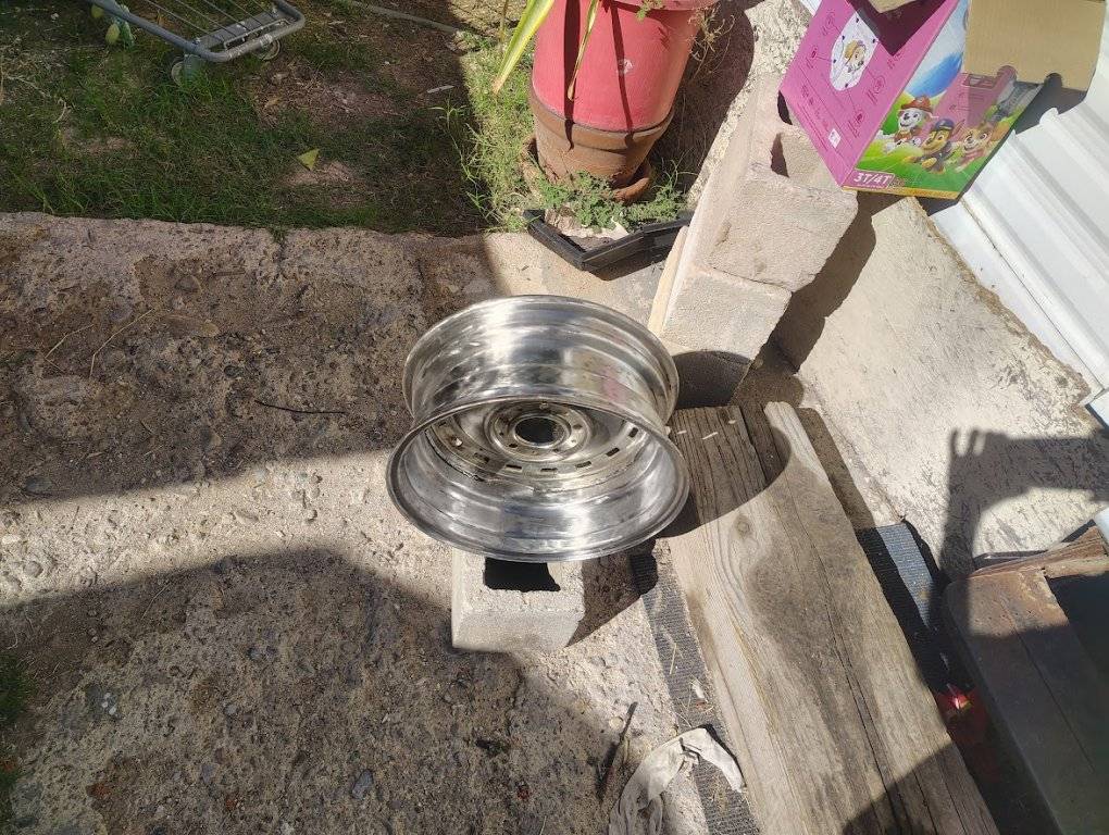

One can readily see the Arizona "patina" of rust around the rim, everywhere but on the chrome plating on the outside meant for public viewing. So, I bought a good stock of Duplicolor for rims, and with the cooler weather commenced to remove rust and old paint. Now let's see what I discovered for my effort to date:

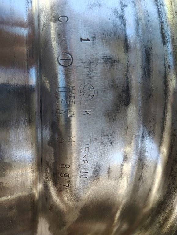

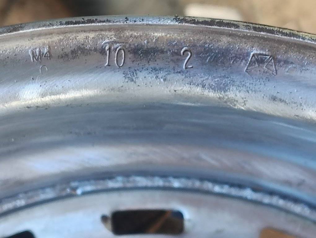

NICE to see the old factory stamps emerge from the steel! I definitely WILL clearcoat these and tape them off after before I prime the rest of the paintable surfaces. I also will protect well the chrome-plated outside facing well before I spray at all. Be this as it may. those stamps show the authenticity of the rims. I expected an ordinary steel shine to this, but looking at the rim as I can now, suspect they may well be made of a stainless steel; thus the title of this thread. Does anyone KNOW?

The W23s which came OEM on my '70 Monaco Brougham are pure steel. Which is why they rust. The chrome is only on the area where the slots are, or the whole center, covered in the matte silver paint. The OEM chrome is designed to be more "satin" rather than "bumper chrome". Also obviously thinner, too.

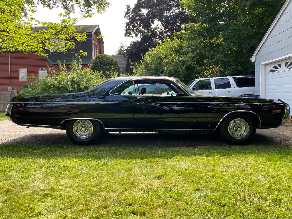

My favorite C Body wheels. Mine cleaned up nicely. I have another set for just in case another C body comes along someday.

Oh yes! But I MUST put the effort in to remove ALL the old rust and paint. Tempting as clearcoating the whole job is, I'll stick with the plan to prime, then use factory silver in the proper places, and to buff the chrome as well as I can. Fine steel wool does wonders for chrome plating, with plenty elbow grease for the polish. Tempting as 235/60s are, I'll likely stick with 225/70s, which closely match the diameter of the 215/75 14s on the car now. I would rather not have to diddle with the speedometer pinion gears, though I've a decent set of them, as my current one matches the GPS speedo very precisely.

235/60's are too low of a profile for a big ole C Body. The taller 70's will look better. That is what I have on my car as pictured.

LOVELY NY'ER! Very tastefully done. I got my wheels for a truly Providential price, and am glad, especially looking at what you did with yours.
