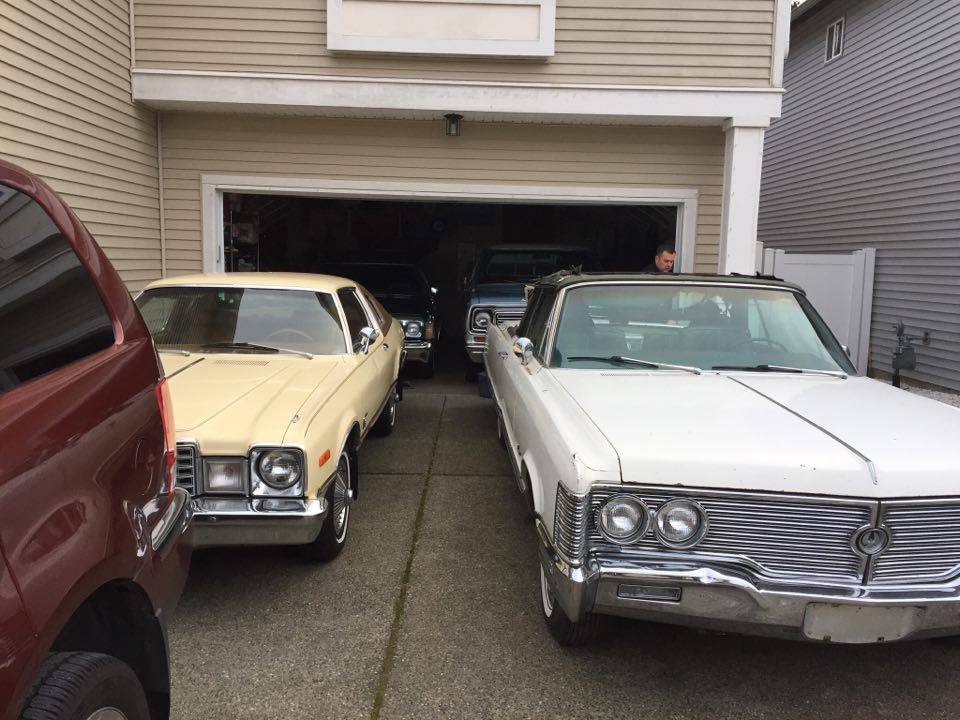

Couldn't agree more! Here's my Imperial wearing terrible Pep boys inserts on the factory stainless arms...bloody awful! I bought a set if Imperial factory stainless wipers from Detmatt...and the change is incredible.
