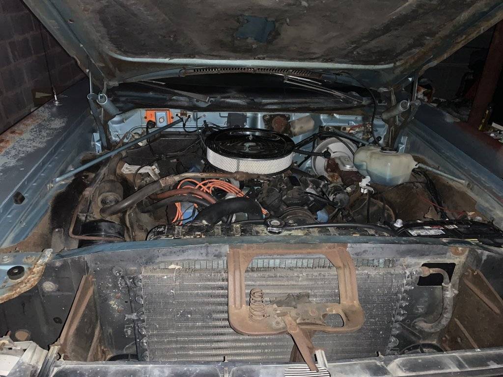

Mine just has a shiny black plastic vac tank under the hood (near the front corner) which goes straight to the firewall and under the dashboard. One vac line from engine to vac tank and 1 from tank into the firewall. No water valve (has a manual valve setup) or time delay thingy
You can see the setup on the pass side in this pic. The vac line that I assume was for the water valve is hanging loose (capped off with a screw)
