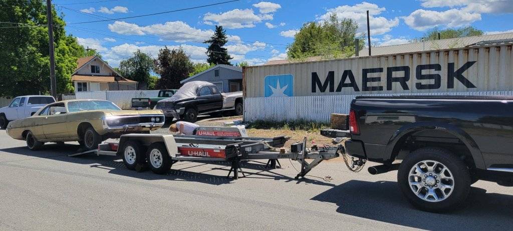

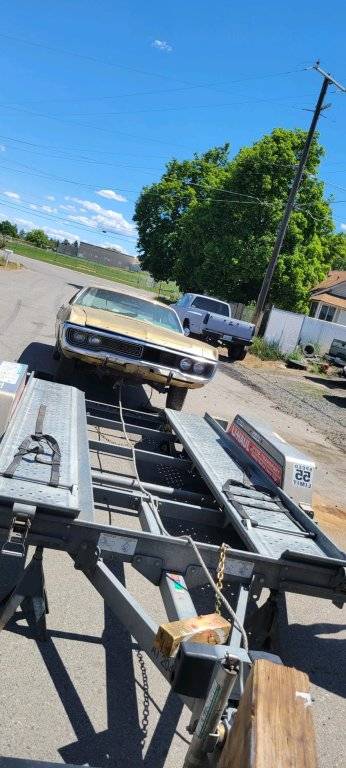

Ive done this twice. Both times were to load a car on a trailer. Not to get it down the road however im not sure why it wouldn't work short term. I put the rope around the center of the stub .

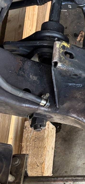

That looks nice. But you've lost some threads for the LCA pin's nut, don't know if that makes a difference or not. But you are absolutely going to be pulling on those fewer threads. Not as much load if the car is rolling OK, but if stuck in mud or with a locked brake maybe that nut might pop off? Pulling it onto an inclined trailer or roll-back recovery truck increases load, too.
And don't forget to put the cotter pin back in.
