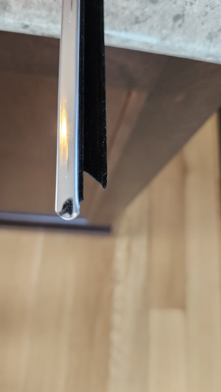

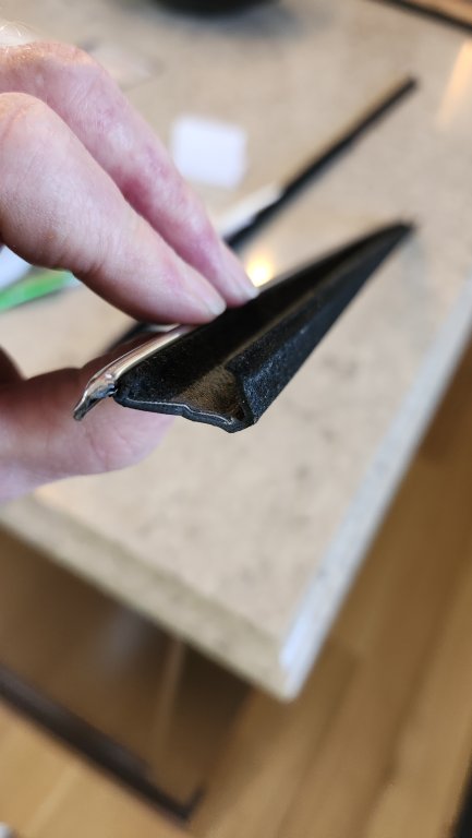

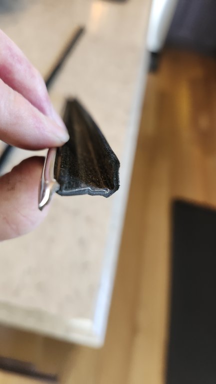

Does anyone have a picture of the topcat brand door panel side, window fuzzies? I have a set of pui and they are not like the original ones at all. They have a flap that I guess the window is supposed to hold up, but even with it pushed up tight, it doesn't reach the chrome piece at the top. The outers look correct. I was wondering if the topcat ones looked closer to the originals. The original have no flap and are stapled through the felts.
Just refreshing the post. Hoping that someone can help who has purchased and installed topcat door panel side cat whiskers on a slab side. I have a set of PUI brand and they are not like the originals. Was hoping someone could advise on the topcat brand before I order a set. Thanks in advance.

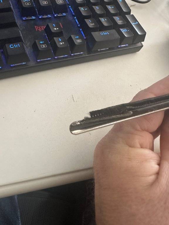

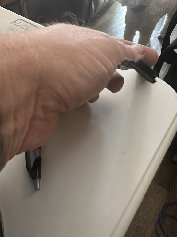

If these aren’t the right ones, the other ones are already installed in the car. These got set in an odd place and i couldn’t find them at the time 65 Polara 500 2 door
I bought the Top Cat whiskers for my 65 Sport Fury years ago. Both inners and outers. The outers came with the correct mounting clips and the inners came without since they were stapled in from the factory. Other than the clips, the inners look just like the outers.I didn't have the staples or stapler so I used small pop rivets to install them. Those inners you were supplied are not correct. I'm sure 66 C body cars are the same. I would get the Top Cats if they are available. I know sometimes they are out of stock.
