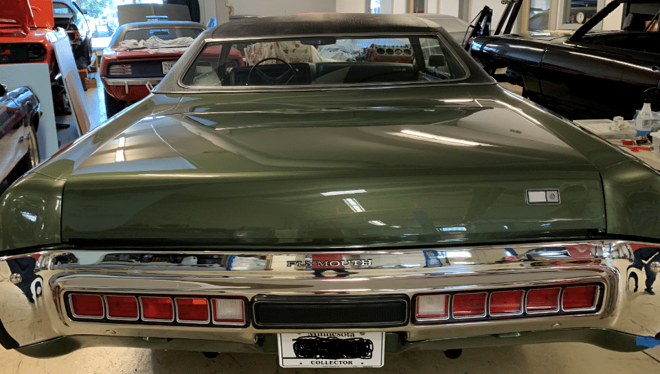

Ok this upcoming weekend a friend of mine and I will be attempting a windshield replacement in this 72 Monaco

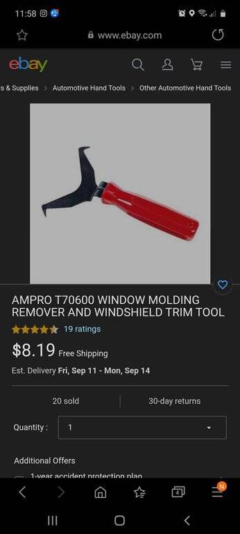

I've been told I'll probably need this trim removal tool

That tool is gonna piss you off. I have some thin metal wire made for cutting glass out from working at the salvage yard, that stuff and some vice grips always does the trick for me. Let it sit out in the sun with the trim off for a while to soften that crap up too.

That’s exactly what you need to remove the stainless trim to release the clips without bending your trim.

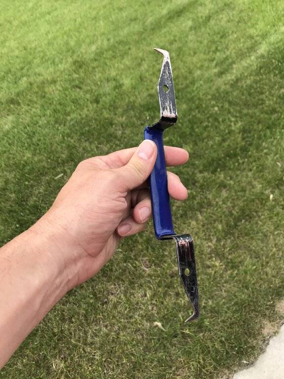

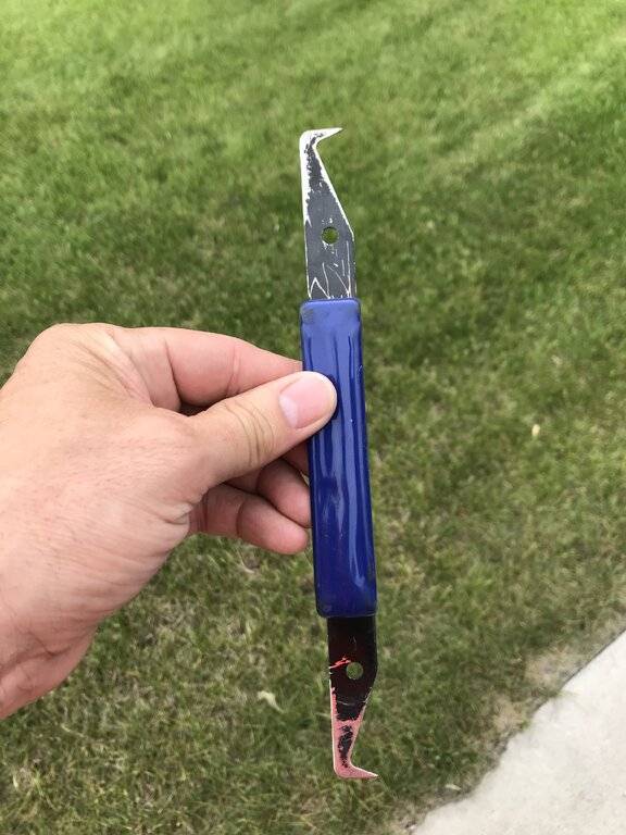

Shot of the one my glass guy used for trim removal.
I made one with a cheap 1/4" screwdriver. Clamped it in a vise, heated the end red hot with a propane torch and bent the tip over 90 degrees with a pair of vise grips. Slip it under the trim, slide it along until you contact one of the clips. Gently move the handle up and down until the clip releases.
Don't waste a quality screwdriver for this, a cheap harbor freight tool is best.
