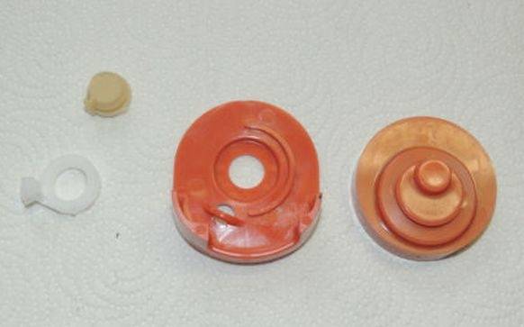

This ebay listing has a few for sale. It also states it works on 75 to 83 model cars. Check it out.
1979, 1980, 1981 Chrysler New Yorker Newport windshield wiper repair kit | eBay
As mentioned those are for the FMJR body cars, not the C. Worked great on my daughter's Volare though.
I heard.......
That if you swapped out the offset linkage piece that mounts to the wiper motor from a 79 Cordoba that this bushing will then work on a 78 C-Body. I don't know if the offset is different, if the piece will fit on a 78 wiper motor, or if the park position changes.
If any one can expound on this theory let's hear your thoughts and comments.

You can fabricate it from donor parts from a 74-77 C -body than you can use the small bushing that is still available from Mopar.
That is the only fix......

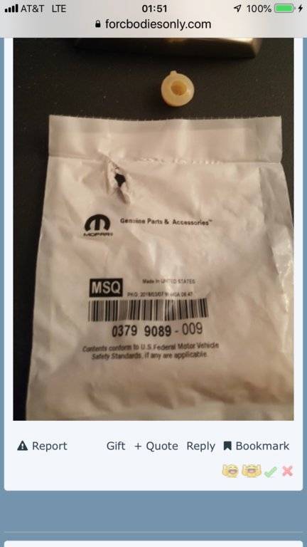

You probably need a bushing. Still available from Mopar.
