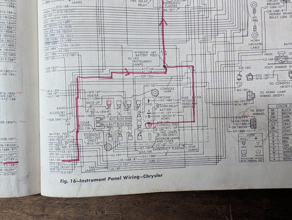

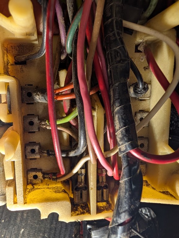

I started to trace and repair no backup lights. The 69 fsm shows the black and black w stripe from the trans to the fuse box. Good switch good ground, no lights. I pulled apart fuse box and it shows wires changed to white w/ white stripe inside fuse box. Fsm shows white going to purple wire at floor sill and purple wires go to back up lights. No circuit. Fsm shows purple wires change to white then go through fuse box. Simple circuit. Trying to trace two white wires, they go up into dash and I pulled dash and still haven't got to end of white wire. Fsm does not show all this.

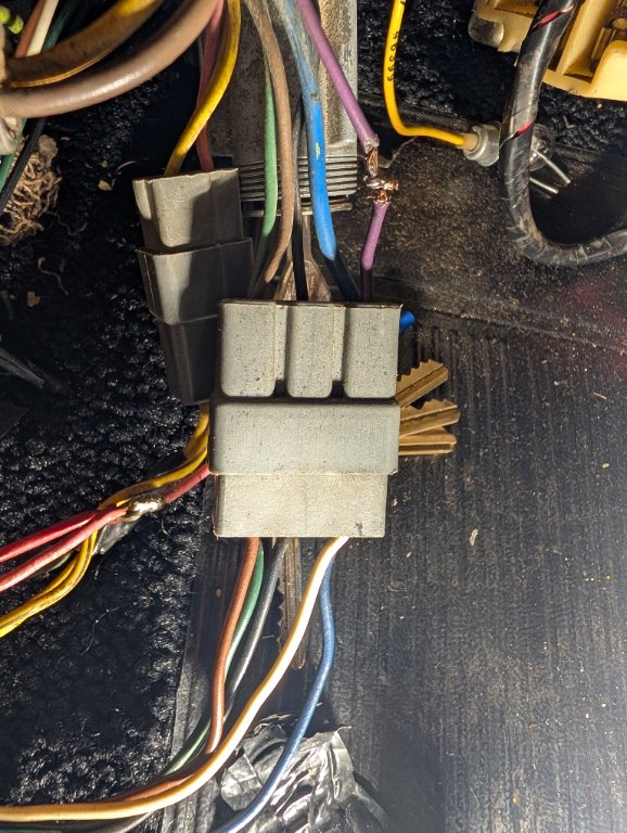

Back up lights have good ground and work fine if I jump power to purple wire connector at drives kick panel.

Ignore the heavy red marks. They were in book when I got it.
Diagram shows white wires coming into and leaving fuse box.
Diagram shows connector and turns to violet on other connector.
Hots and grounds and fuses test good in fuse box. Lights work when applying power to violet wire.

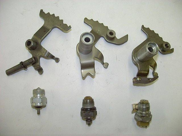

Probably has the wrong rooster comb on the valve body. Should look like the one on the right in this pic. Any idea what year the trans is? Gotta be 1969 and up.
If you take the switch out, you may be able to see if it has the correct rooster comb.

The numbers on the pan rail will tell you something about what transmission you are running. Heaven knows what valve body is in there tho'.
As a cure to no reverse lights, you might be able to simply use a different neutral safety switch (68 down?) rather than mess with pulling the pan. You'll have to change that wire harness to the trans (again).

ope! i should stick to what i know... 69 up! Thanks John.
What a wonderful picture! Thanks!
If the comb on the right is 1969 and later, what year spans do the the other 2 combs cover?
Not my picture, I stole that from Moparts a while back.
The left comb is for a cable shift, so '65 and down. Center is '66-'68. Right is '69 up. That just identifies the NSS part and there may be other nuances that affect how they interchange. I read that the right one is actually a '71 and there's a slight difference in the shift detent between that and a '69-'70. If that makes a difference, I really don't know.
