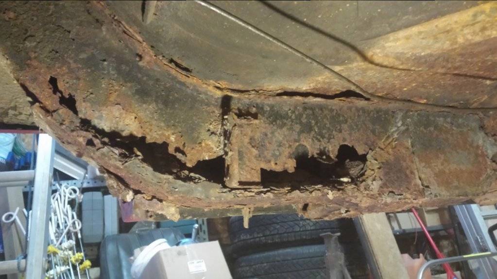

Now that I see the pic's of the underside I see what your up against, a donor section my be the best way to go.
I do have a rear frame section complete. I just have to take a leap of faith in myself and dive in. I have actually started removing a few things underneath already. getting ready to take the axle out when I can get the chance. Then I can start cutting out the old frame.

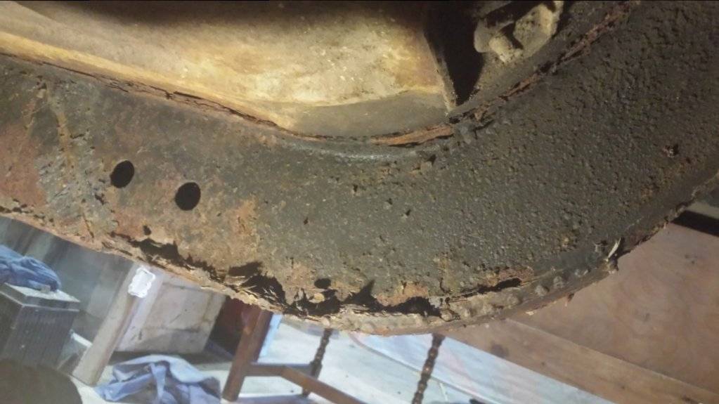

Firstly I would like to thank everyone for the welcome. As I stated before I have a 68 Monaco vert that has some serious rust issues with the rear frame. I knew this when I bought it so no surprises. I am finding out that c-body parts aren't quite available as I thought they would be. I have been lurking in the background watching some threads, ( not trying to sound creepy ), and I have seen so many offers of help and encouragement. I didn't want to post anything until I was ready to start into this project. I am not going for a full resto, my budget and time is at times limited. I will definitely welcome any advice any one is willing to give.

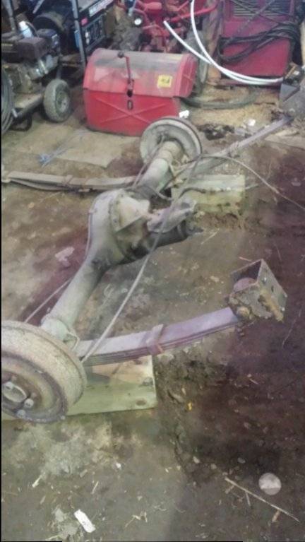

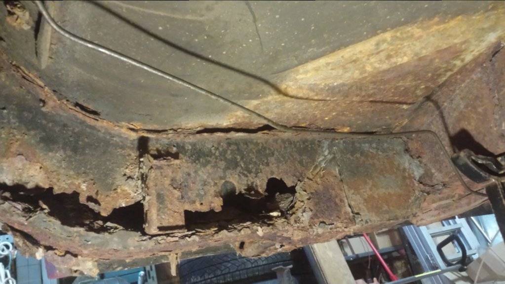

so I removed the rear axle today and got a better look at the front sections of the rear frame rails. Not much better than the rest of it. I think that I will cut out the floor pan before I remove the old frame. I'll need to find all the spot welds and cut them out. Is there a specific brill bit for doing this or do need a regular bit?
There are drill bits specifically ground to drill out spot welds. It "can" be done with a regular drill bit, but these spot weld bits make life a whole lot easier.
Am I seeing a small rectangular brace inside the remnants of one of those frame rails?
Thanks for the info, I'll see if I can get one at the local carquest tomorrow. I think the brace you are referring to might be the bracket for the parking brake cables.

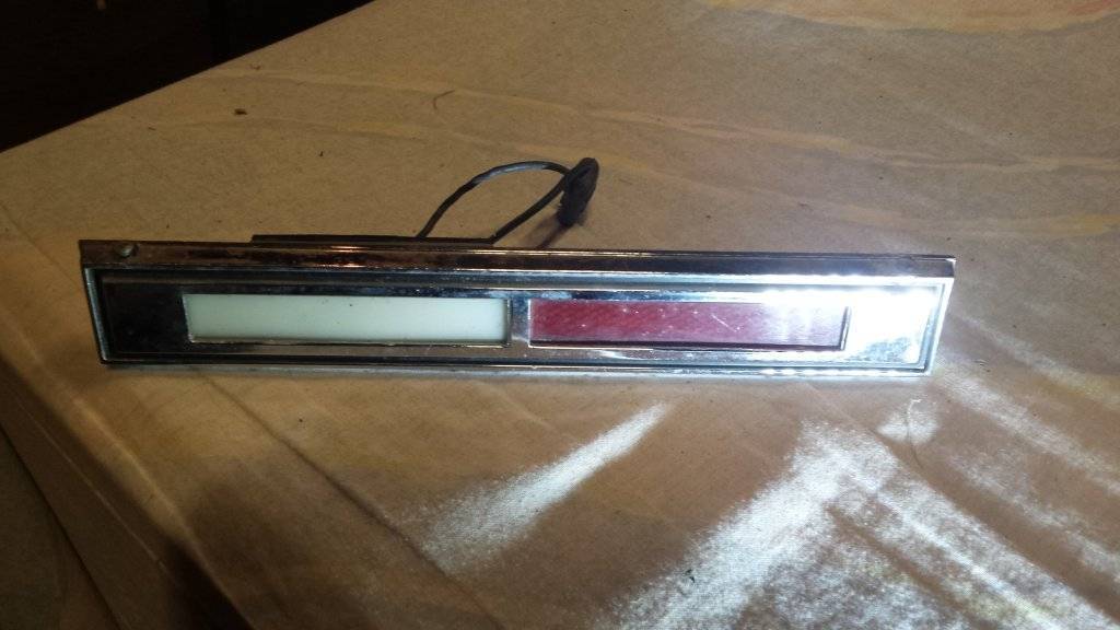

does anyone know if this belongs to my car or any dodge product. It looks like a courtesy light of some kind.

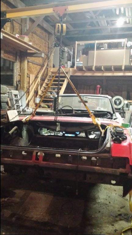

only did a little on the trunk, might have some more time later. If someone can give some thoughts about how the back end is supported, ok, not ok
Does the white lens light up and the red lens is a reflector? If so, then I'm guessing it's a courtesy lamp assembly for a front door, mounted in the trim panel.
