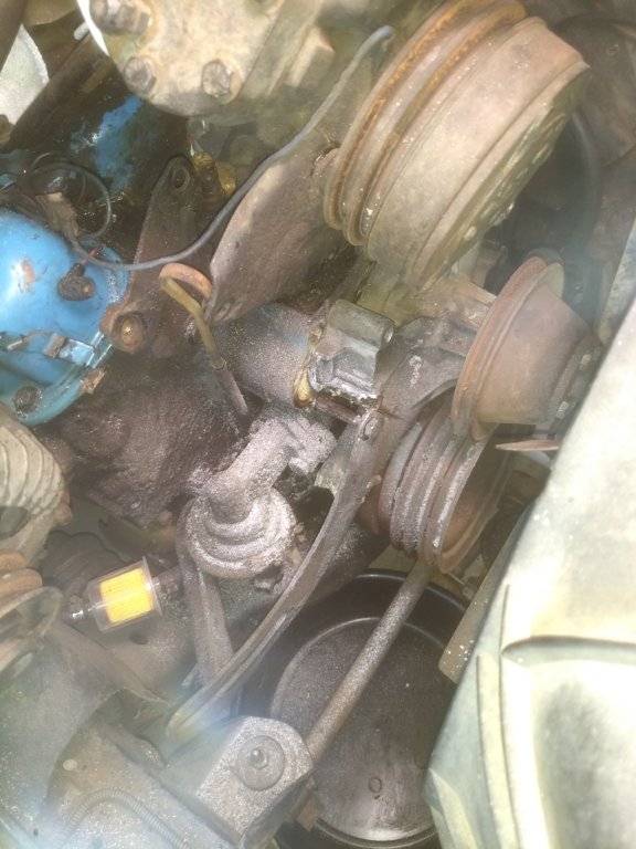

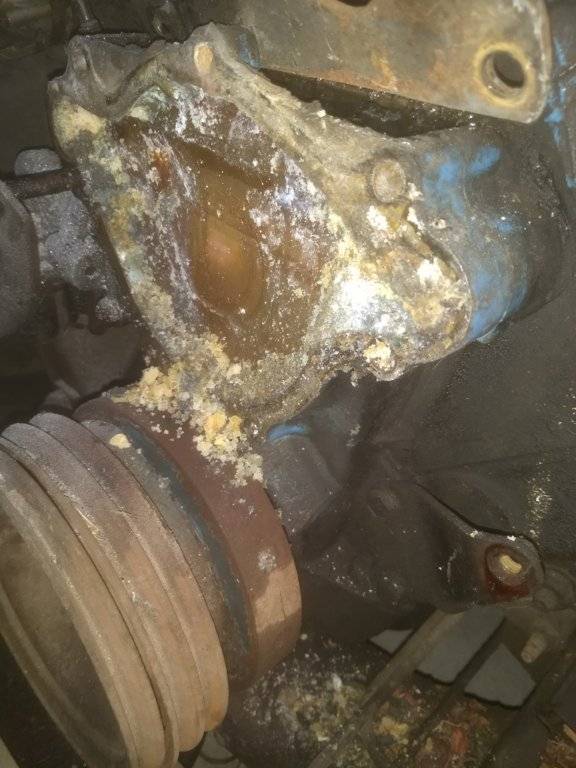

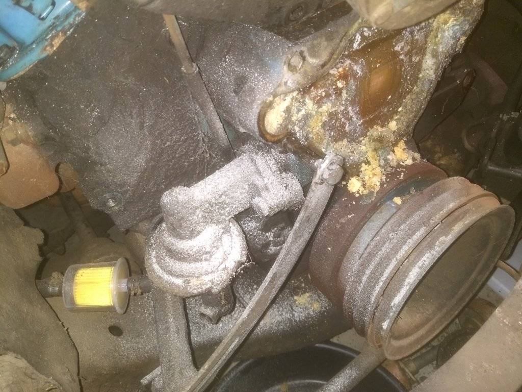

So I have spent time cleaning this up. here are a couple of pics...anyway, I posted this question under mechanical as well to maximize exposure for an answer... don't know if that makes a difference and any advice on protocol/good manner is appreciated
