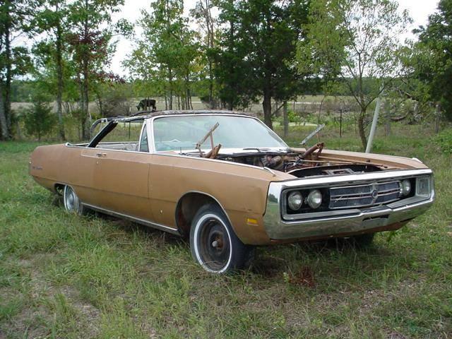

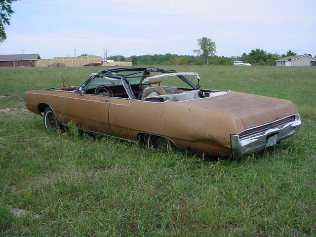

From southern IN. Been lurking a couple months and finally decided to post. I recently bought this 69 300 L code vert from MO. I don't have it home yet and plan on going after it early in Nov. I am usually a B Body person but a few years ago I traded for a 67 300 L code hardtop and loved the car. I have regretted getting rid of it ever since so when I found this one I decided to try the C bodies again.
I have a steel crank motorhome 440 that I am going to change the heads and cam (and all else that needs swapped to fit the 300) and back it with a 4 speed.
Here are a few pics of it at the current/past owners place.

Welcome. Can't wait to see another fuselage car running up and back on the road. Sounds like you have some good plans for the 440.

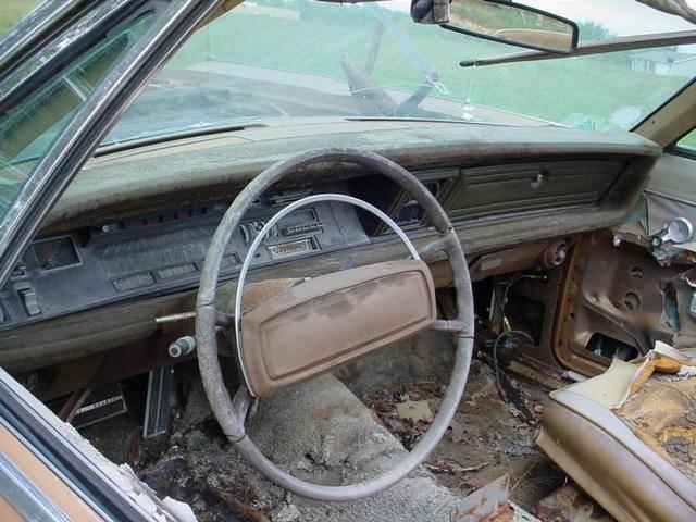

I noticed that dashboard is almost arrow straight, even after being exposed to the weather. That's outstanding. Nothing worse that a fuselage dashboard with wavy melted parts in it.

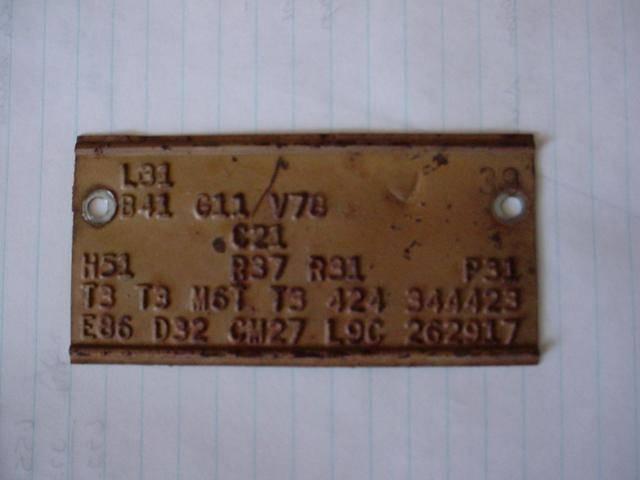

Does anyone know what stripe the V78 refers to?
