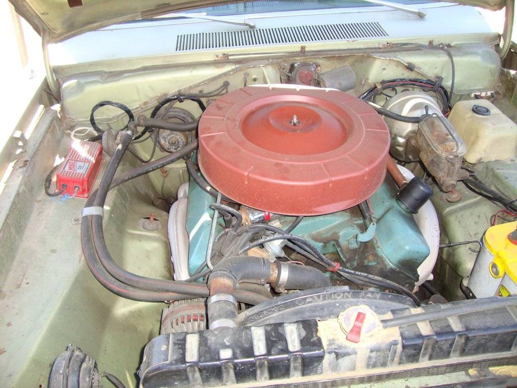

I have a 68 New Yorker with a standard 440 with 30,000 miles. This car has been sitting most of its life until recently. When it sits it leaks pretty good. Im assuming its the rear main seal because the valve covers are dry along with the oil sending unit. Is there anyway to easily drop the pan and repair the seal. Or is there any quick fix that I can just buy at the auto store?

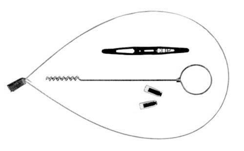

there is a tool that can pull a new rope rear main seal in , there is a lot of undoing of oil pan , and losing of the main caps so you can rotate the crank to pull one out and replace it with the new one . no quick way , i just pull the engines an re-gasket them completely , change the freeze plugs and timing chain as well . all the rest should be fine , but it could be overhauled as well , rings , bearings , ect....

The rope can be done in the car. That's how the tool got developed in the 40s I think..lol.
But - if it were me I wouldn't do it. I've done a few and they are hard to get to seal. So I'd stick in a lip seal to see if it holds. If not, then pull it and do the rope.
