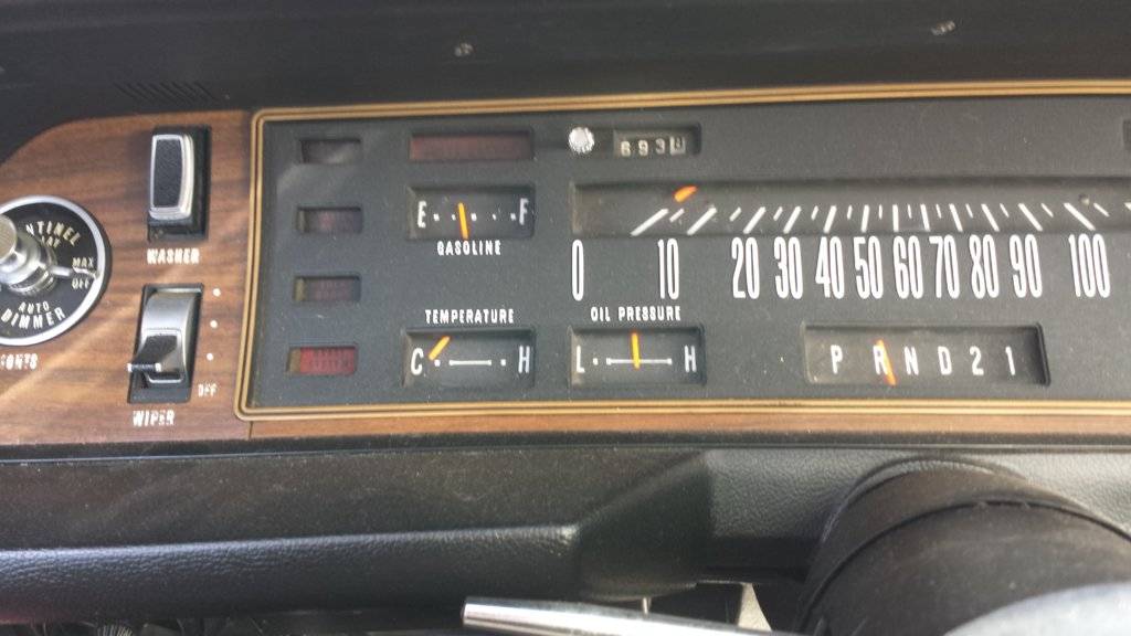

Hello,
Today I made the first ride of this year with my 72 Imperial.
What do you think of the temperature and the oil pressure? The temperature gauge first goes to halfway and then drops down again. The oil pressure seems a bid too high, or is this normal for a 440ci with almost 90.000 miles on it

From what you describe, the temp gauge is acting about right. If the small "over-shoot" on the temp gauge worries you, then drill a small hole in the flange on the thermostat. What does it read at 60mph?
The oil pressure should not be an issue, as long as it isn't too low. On many of the cars I've seen with an oil pressure gauge, at idle it's usually at the 1/4 scale mark, then goes higher as rpm increases. Depending upon the weight of oil you're using, PLUS how far you've driven it, those can affect it too. It usually takes about 10 miles of highway driving for the oil temp to approach coolant temperature. Where does the oil pressure go with engine speed of about 2000rpm (or "road speed")?

If the fuel gauge is reading accurately, most likely you are getting good voltage to the rest of the gauges. Both the temp and oil gauges with the readings shown are within normal parameters. If you are worried as to the accuracy of your oil and temp gauges, put a thermometer in the coolant once the engine has warmed up and the thermostat is allowing coolant to circulate. You reading should be about the same reading as the thermostat. If you have a thermostat that is OEM or a same rated temperature, your gauge should at about the middle of the operating range as shown by the solid line at the center of the gauge. Most cars this age have had the thermostat replaced and often folks replace them with a lower temp rated unit. I would pull the thermostat and check the bottom of it for the temperature that it is rated at to see if it is correct. An engine with a "cold" thermostat will often have higher than normal oil pressure because the oil viscosity has not been sufficiently reduced by normal operating temperatures. Oil that is running too cold is more prone to forming sludge because contaminants are less like to be dispersed out of the oil at lower operating temperatures.

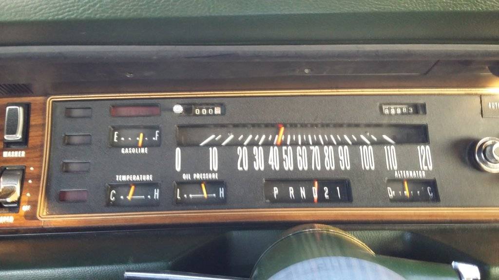

Mine (72) at start of car trip today backing out of garage after about 30 seconds...I can take one after running awhile. Usually both at midpoint or a little over to the right of midpoint.
