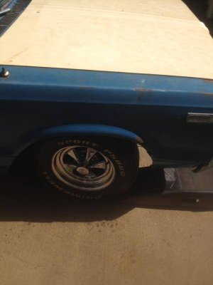

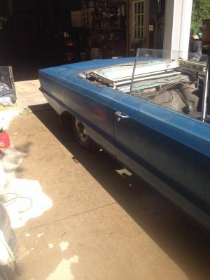

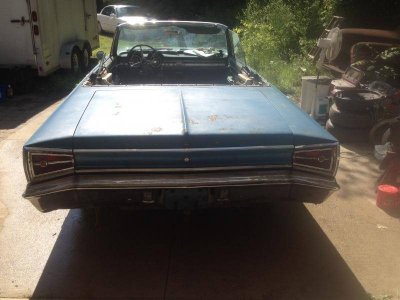

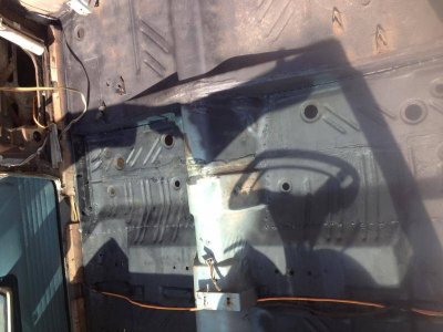

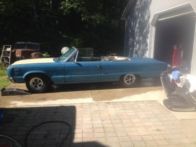

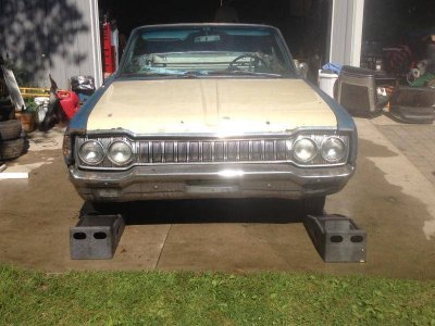

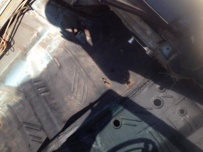

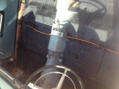

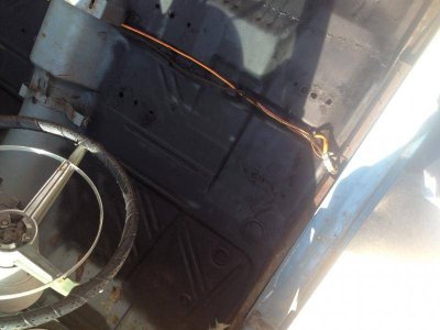

After that, pics of it's current condition. And finally, what do you want it to be.
Oh... And total budget.
Alright, I can do that.
Little about me, currently I am in the army stationed at Fort Drum, New York. My car is located in Michigan at my folks house because the base has limited space in the family housing. I can make trips to my folks house but only a few times a year.
My type of restoration is for a good driver that I can take to shows and just enjoy.
As for a budget, I don't know yet. That would be up to my wife but for now I am just in the planning stages and saving money. I know that I could easily get out of control on this but for now I am just trying to plan my limited time and money.
Pictures I can post.
