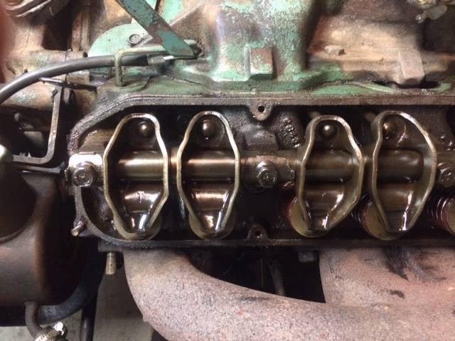

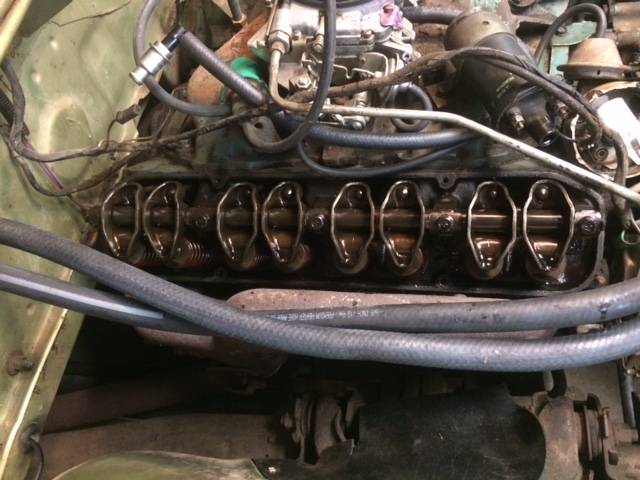

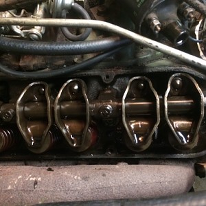

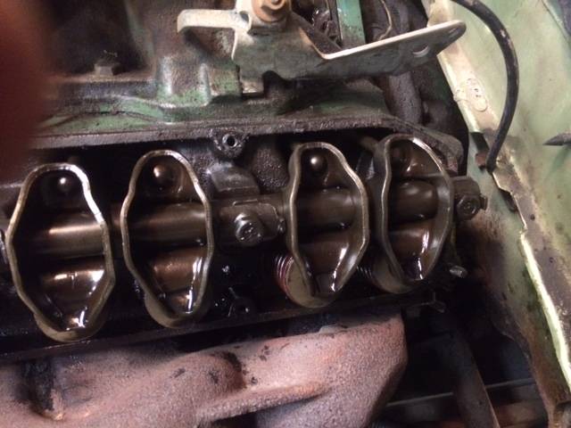

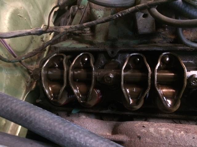

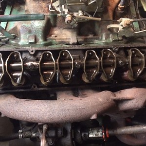

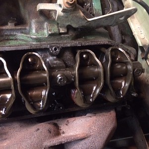

In the spring of 2017 one of the tasks was to change valve seals.
General Information

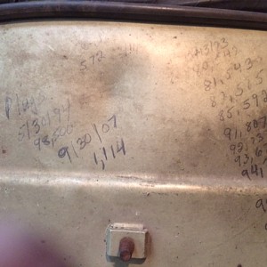

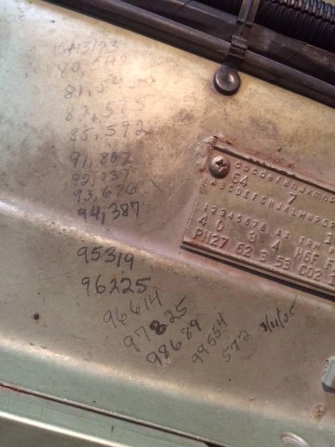

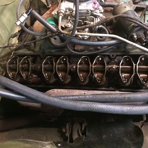

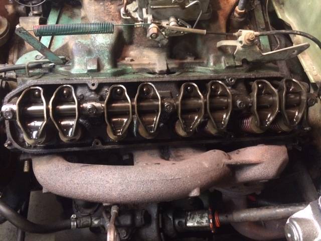

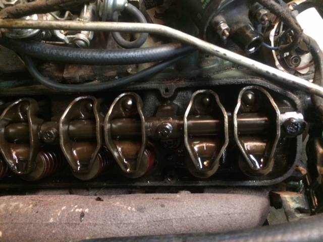

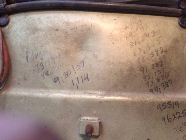

This is a 1968 383 H code engine. I had had that tell tale puff of smoke when starting. When I got into it, the valve cover gaskets had engine paint on the tabs so I don't think they had ever been off. These pictures are of what I found, as you can see, the prior owner(s) were diligent about oil changes, (see notes on fender). As far as the seals, only 4 of the 16 were intact and they were hard and brittle, the rest were pieces. What a difference when done, oil consumption dropped to near nothing, (there is still a small seal or oil pan gasket leak) and it ran much better and even improved the sound from the new mufflers. I guess I was running a semi-diesel.

That car had one compulsive owner! Changed oil every thousand miles and recorded changes on the engine compartment sheet metal!
I did swap emails with him. He bought the car in 72 with about 72-75k on it. Put barley another 30k on it in the 40 years he owned it.
rubber gets old & hard being in oil for years its called maintenance to change there from time to time in the old days after 50-60,0000 miles it was time to change them now maybe the ones they make these days may last longer but we change ours after 50,000 miles anyway
