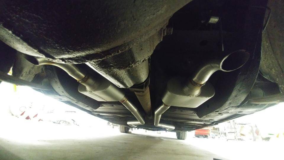

The project continues, finally had time between customers cars and other projects to get some work done on the 62 we started calling "Large Marge" as a joke!
General Information

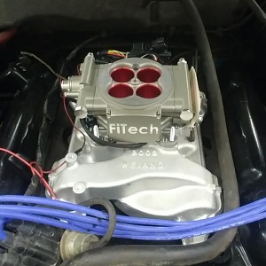

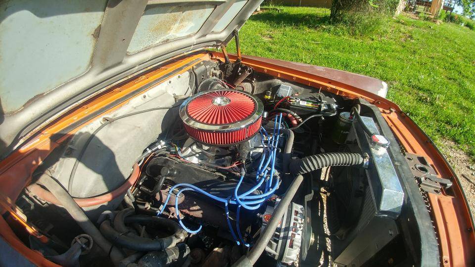

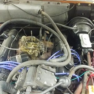

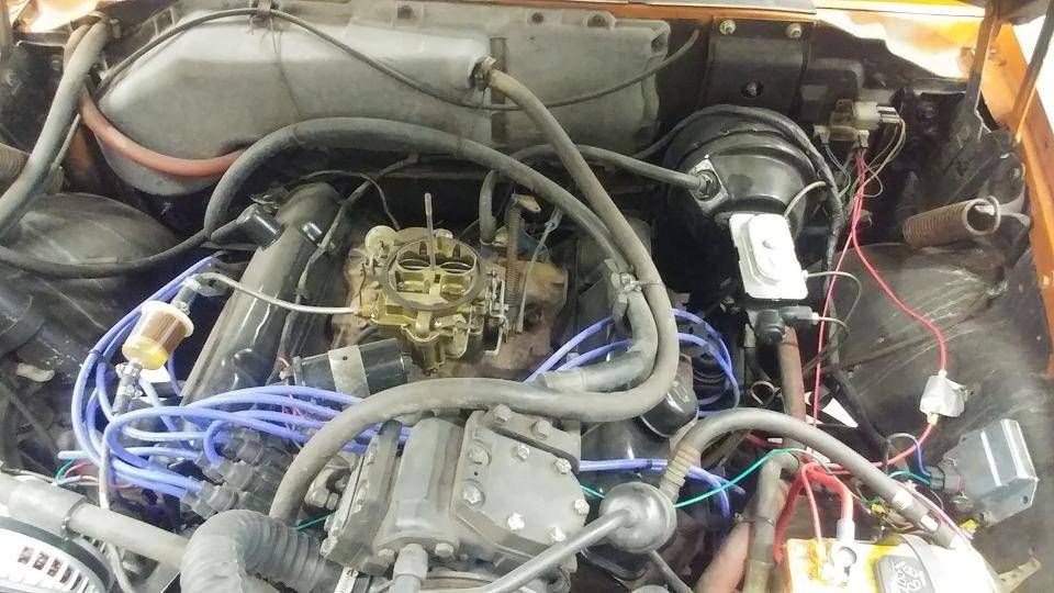

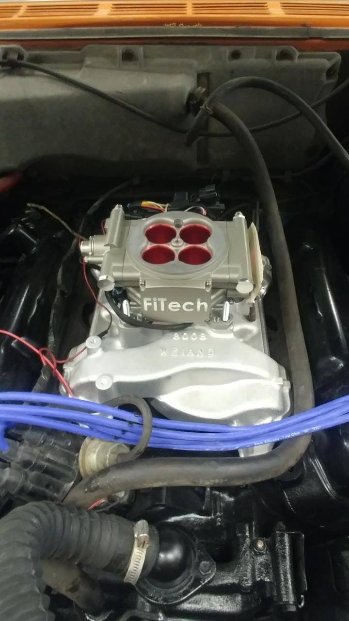

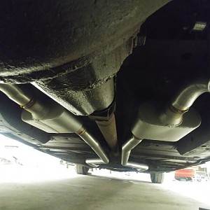

Finally got it to the exhaust shop after scrapping and recoating the underside of the floor. Cleand up the engine compartment a bit. Added an aluminum radiator and electric fan, 95 amp alternator, new water pump, PerTronix ignition w/ new coil, high torque starter, 4 barrel intake and Fitech EFI. She starts and runs way better now and sounds mean!
Next will be rearend swap and front end rebuild, then wheels and tires upgrade. Then hopefully body and paint soon! I will keep updating as the build moves forward.

In just the efi, I think fitech complete kit was $900. Then new intake, so $1,100.
It's a bit off a job but you can do it in a day. Be very careful where you mount the fuel pump because it will vapor lock.
Top end and throttle response are leaps above the old 2 barrel carb. Transmission shifts better too. Vacuum is not an issue everything is working well. There are several vacuum ports to choose from on the throttle body. Probably have around 400 miles or so with the efi installed.

Starting is better too, but I had a lot of issues with the original starter and points. New igintion and high torque starter solved a lot of my start problems. You can set the idle where you want with the fitech controller.
