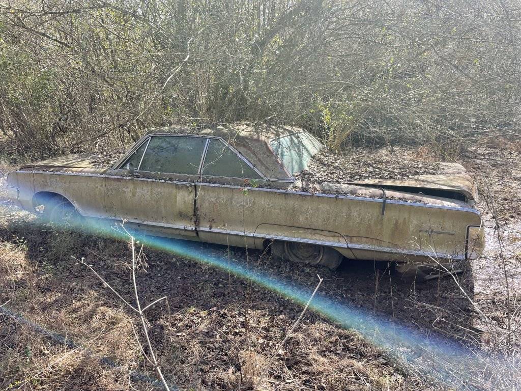

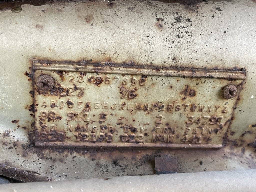

I found this today and would like to know the engine size. The engine and transmission should be under the A&B which is 99. Going thru the “White Book” I was able to figure out the exterior color is Moss Gold. Even My Mopar has me stumped. :thankyou:
Typical 1965 fendertag codes that I know of at this point follow.
Starting from left upper corner with row 1, 2 and so on, 1=2 means there's a # 2 under digit 1.
First row:
1=1 left manual o/s mirror
1=2 left remote o/s mirror (only available after build date 11-11-64, except on Imperial.)
1=4 Spotlight 5 inch, mounted
2=1 right manual o/s mirror
2=2 Fender opening reveal skirt
3=9 variable wiper w/ washer
5=5 lower body finish panel/ applique (Chrysler)
6=0 black conv. top
6=1 blue conv. top
6=2 white conv. top
6=3 tan conv. top
6=5 black vinyl roof
6=6 white vinyl roof
6=7 brown vinyl roof
7=2 sold car
8=5 stone shields
8=7 front bumper reveal moulding
9=1 moulding - door upper frame (C-body) [The only car I have seen this on is a C-body: a 4-door Newport; but I guess it could apply to all low grade sedan A and B-body too.]
9=6 Lower decklid moulding (Chrysler)
Second row from top:
AB=10 170 cubic inch slant six
AB=20 225 cubic inch slant six
AB=30 273 cubic inch v8
AB=31 273 cubic inch 4bbl
AB=40 318 cubic inch
AB=50 361 cubic inch
AB=60 383 cubic inch 2 bbl
AB=61 383 cubic inch 4 bbl 330 hp
AB=62 383 cubic inch 4 bbl 315 hp (only C-body)
AB=70 413 cubic inch 340 hp
AB=71 413 cubic inch 360hp
AB=80 426 wedge
AB=82 426 hemi 425hp
AB=91 special order
AB=99 standard cid engine 8 cyl ( w/ positive crankvent system)
B=5 Plymouth C-body 6 cyl.
C=2 safety group (Chrysler)
C=2 Barracuda Formula S package
C=5 Performance package incl: 273 cubic inch HP 4 bbl, suspension package + power brakes.(Valiant/ Barracuda)
C=5 Polara 500 Sport Package (Dodge )
D=1 3-speed
D=2 3-speed heavy duty
D=3 4-speed
D=5 automatic
E=1 a/c w/ heater
E=2 a/c w/dual unit
E=3 a/c w/o heater
E=5 heater w/ defroster
E=6 delete heater
F=1 Power brakes
G=2 6-way bench
G=3 left bucket (4 way power)
G=4 4 way power seats (both)
H=5 power window
J=6 power vent. windows
K=7 power tail gate S.W
L=8 auto pilot
M=9 power door lock
N=0 power top
N=1 roof rack
N=2 assist handles S.W (incl. deflector, coronet)
N=3 roof rack+ assist handles + deflector
N=4 Wind deflector
N=5 Roof Rack + deflector
N=6 Release knob deck lid Taxi
N=8 rear defogger
P=7 powerdeck lid
P=8 Front console
Q=1 a-m music master/economy
Q=2 a-m astrophonic deluxe
Q=3 a-m/f-m Q=4 a-m astrophonic w/ rear speaker
Q=5 a-m/f-m w/ rear speaker
Q=6 Radio search tuner
Q=7 radio search tuner + rear speaker
Q=8 radio suppressor package
Q=9 rear speaker
R=1 power antenna
S=6 rear speaker + reverberator
T=8 tach
V=3 back up lights
X=7 front retracting belt
X=8 retract. belt front+rear
X=9 std belt front + rear
Y=9 fender turn light
Z=1 Front bucket seats w / rear seat shroud
Z=2 Front bucket seats and console
Last row:
SQ left digit 1-9 (Jan-Sept) A-C (Oct - Dec) 1964. All w/ # 1-7 are built 1965. Right two digits are
date. Example SQ=B22 are Nov. 22 1964. Number=08065 factory invoice numbers.
B=1 Valiant - Barracuda six cyl.
B=2 Dart six cyl.
B=3 Belvedere six cyl.
B=4 Coronet six cyl.
B=L Dart V8
B=V Valiant (includes Barracuda) V8
B=W Coronet
B=R Belvedere
B=C Chrysler
B=D Dodge
B=P Plymouth
B=Y Imperial
D=1 Low
D=2 Medium
D=3 High
D=4 premium
D=5 Wagon low
D=7 Wagon high
D=8 Barracuda + Taxi
D=9 police
D=0 Charger Hemi S/S
Y=1 2 d.r sedan
Y=2 2 d.r H.T
Y=3 4 d.r sedan
Y=4 4 d.r H.T
Y=5 convertible
Y=6 S.W 2-seat
Y=7 S.W 3-seat
Y=8 4-dr Town sedan (six window)
Y=9 Barracuda
T=L low grade trim bench (buckets on Polara, Newport 2-dr H.T.)
T=M Medium grade trim bench
T=H high grade trim bench
T=P premium front bucket seat
T=T taxi (bench)
T=K police (bench)
R=1 cloth + vinyl
R=2 cloth + vinyl (low+police)
R=3 Leather
R=4 vinyl bucket seats
R=5 vinyl bench seat 2 dr sedan and 4 dr sedan and hardtop
R=6 cloth bench seat (4-dr H.T Imperial)
R=7 cloth and leather
R=8 vinyl + cloth seats 2+4 dr sedan ( vinyl on Fury I)
R=9 Special order (Leather and special order)
M=A gray
M=B blue
M=C blue and white
M=G green and gold
M=L gold and black
M=N black and white
M=P gray and black
M=K purple
M=Q turquoisee
M=R red
M=T tan
M=U black and copper
M=W white
M=X black
M=Y white seats + headlining + gold carpet (Dart) all others Gold
M=Y White seats + gold headliner + carpet (Coronet) all others Gold
M=V red and white
P=Upper body/roof color
A= body color
I=paint style
I=1 mono
I=2 Two-tone
I=3 Sidesweep color + accent (Coronet 440 only)
I=4 painted racing stripe (Barracuda only)
I=5 c-pillar applique (vinyl, Chrysler N.Y.)
N=side sweep color (Coronet 440, Belvedere II), c-pillar applique vinyl color (Chrysler)
T=Upper door frame/molding insert color.
Paint color (letters under P, A, N and T on tag)
Body codes: P = Plymouth, D = Dodge, C = Chrysler, I = Imperial
A = Gold, metallic - C, D,P
B = Black - C,D,I,P
C = Light blue - C;D,I,P (ice blue C,I)
D = Medium blue, metallic - C,D,P
E = Dark blue, metallic - C, D,I,P
F = Mist blue, metallic - D,C,I (pale blue on D)
G = Sequoia green , metallic (dark) - C,I,D (dark green on D)
H = Copper, metallic - P
J = Light turqoise - D,P
K = Medium turqoise, metallic - C,D,P
L = Dark turqoise, metallic - C,D,I,P
M = Granite gray, metallic - D
N = Silver, metallic - C,D,I,P ( pale silver on D )
P = Bright red (Dodge) Ruby red (Plymouth) - D,P
R = Beige - D,I
S = Ivory - C,D,P
T = Medium red, metallic - C,D,I,P (ruby red on D) (spanish red on I)
V = Cordovan (dark) metallic - C,D,I
W = White - C,D,I,P
X = Light tan - C,D,P
Y = Medium tan, metallic - C,D,P
Z = Frost turqoise, metallic - C,I, D (pale turqoise on D)
2 = Sage green, metallic - C,I,D (medium green on D)
3 = Pink silver, metallic C,D,I (pink gold on D)
4 = Moss gold, metallic - C,I
5 = Black plum - I
6 = Mauve - I
7 = Pale gold, metallic - D,I (patrician gold on I)
8 = Yellow - C,D
9 = Special order
Mid year introduction F,G,M,R, 2-8
Note: All cars built in Lynch road, Detroit Mi have digits above the letters in second row from top.
Typical found over letters Q-Z (not shown on pictured tag) Example 15 over QR and 112 over VWX.
First two digits (15) are “gate sequence” #. Second three digits (112) are “base sequence” #.
These digits mentioned above are only found on cars from Lynch Road factory.
Observation # 2: Sometimes there is no digit at all under X (seat belts).
When standard belts were installed, sometimes factory left this info blank.

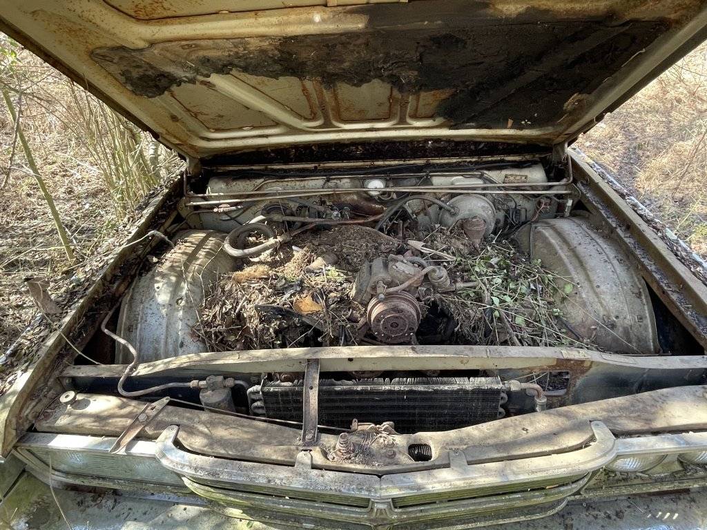

You have to find one of those guys on YouTube that will clean up a neglected yard for free and have them doing a video of them de-vegetating an engine compartment ; )
