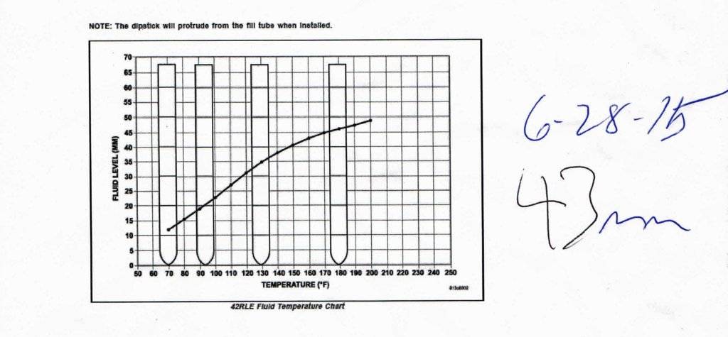

For my wife's 2011 Nitro 3.7 V6 42RLE Trans ATF+4
I agree with changing the trans oil and filter and checking the trans oil DIY
My wife's truck is nearing 100K miles. Have changed fluid and filter twice. No problems. Don't have $300 to pay a dealer, wallet issue.
· Dorman 917-327 Trans Oil Level Tool measured in mm. Purchased at AutoZone $22.10. (Miller Tool 9336A is same but more the double the price.) Correct trans oil depth in mm based on temperature. Measured in mm from bottom of trans pan. Insert Dorman tool until it hits bottom of pan, after trans reaches normal operating temp. Drive it for at least 10 minutes before checking. In our Nitro, trans oil rises with heat very slowly. Coolant temp is not indicative of trans oil temp.
· 185-195 degrees F is normal, so 45mm should be approximately the correct Full, Hot, Trans in Neutral measurement. 220 degrees F should be max temp, so if measure over 50mm, trans is overfilled. Copied from directions I received with the Dorman tool. Similar diagram in FSM.
