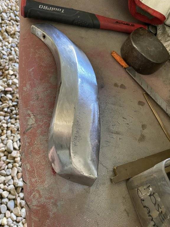

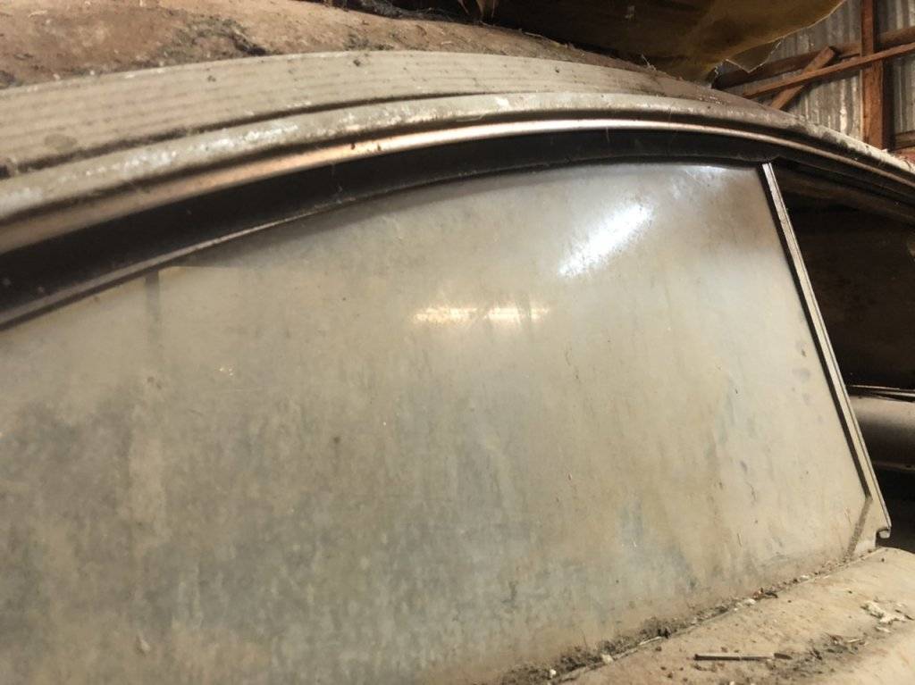

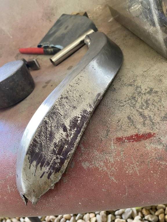

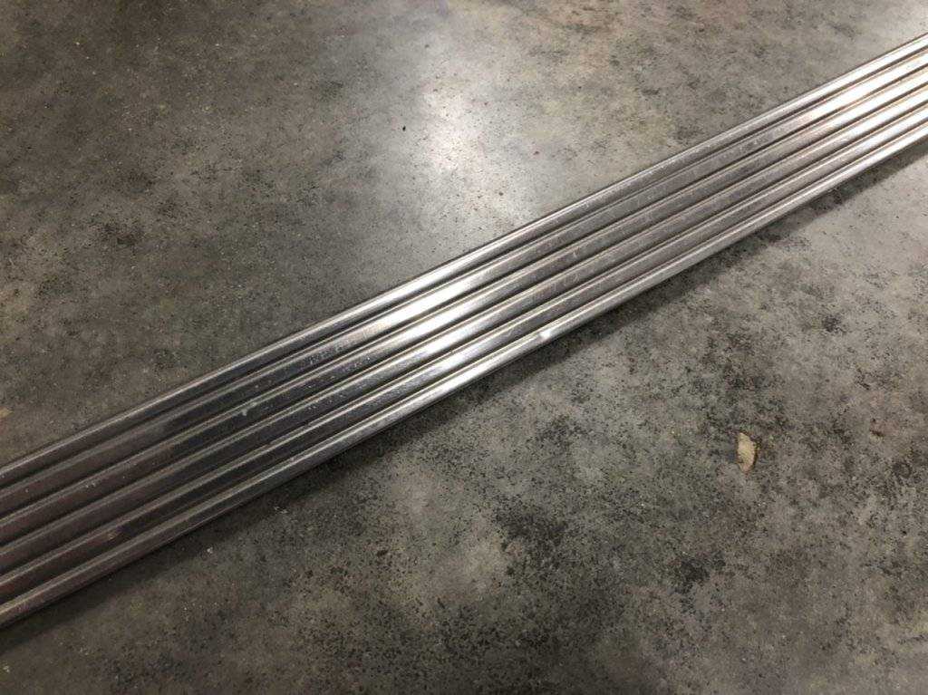

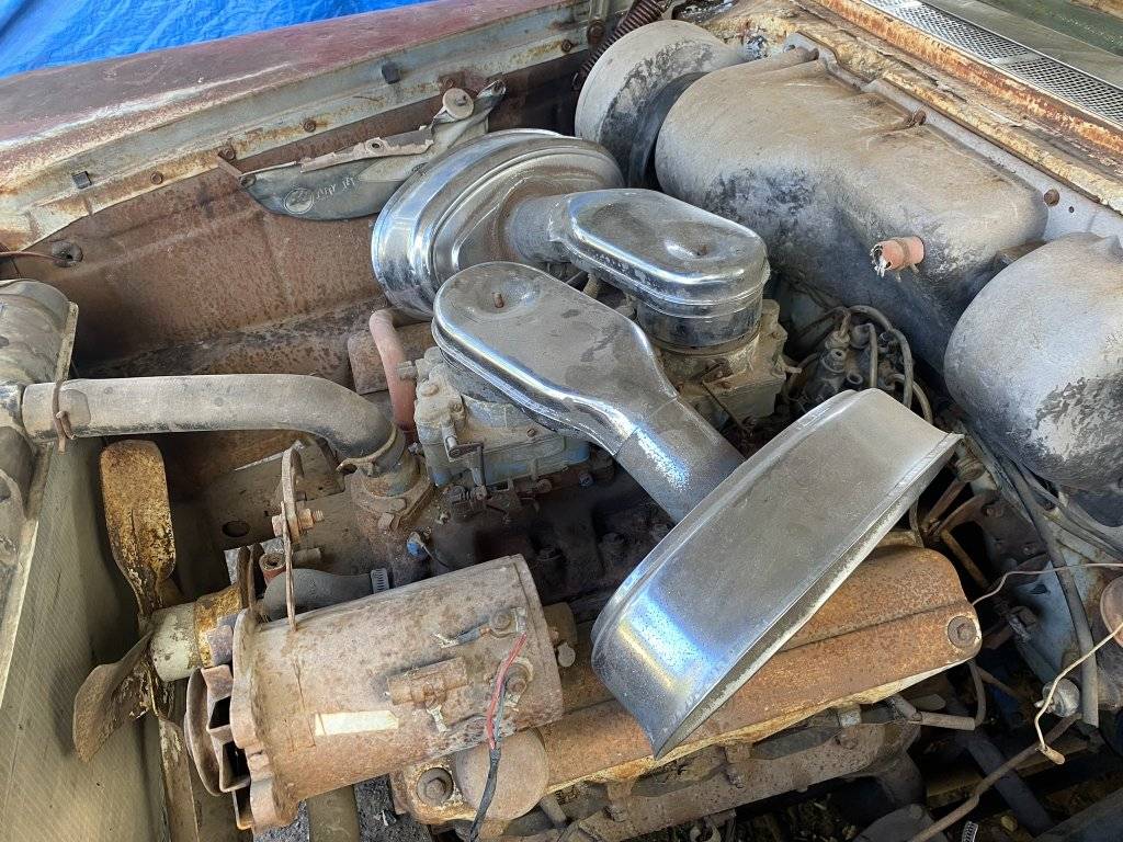

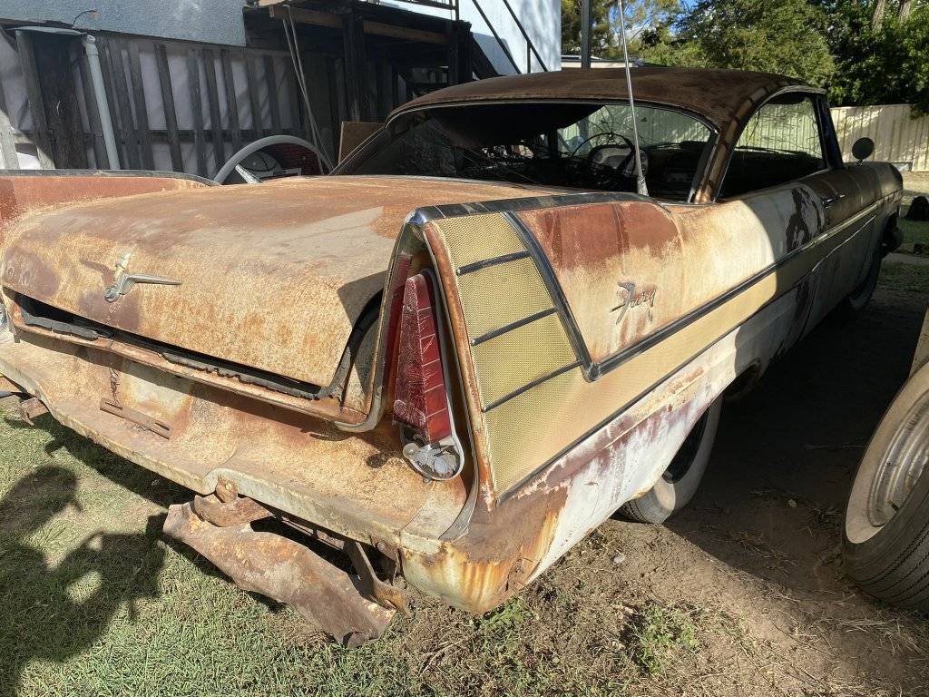

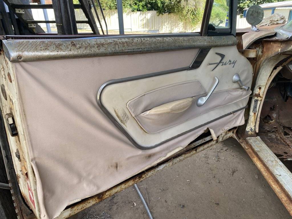

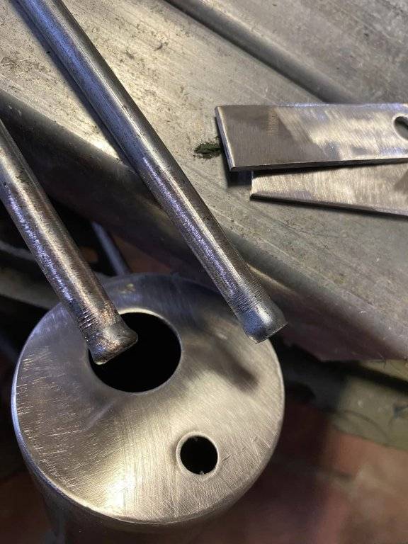

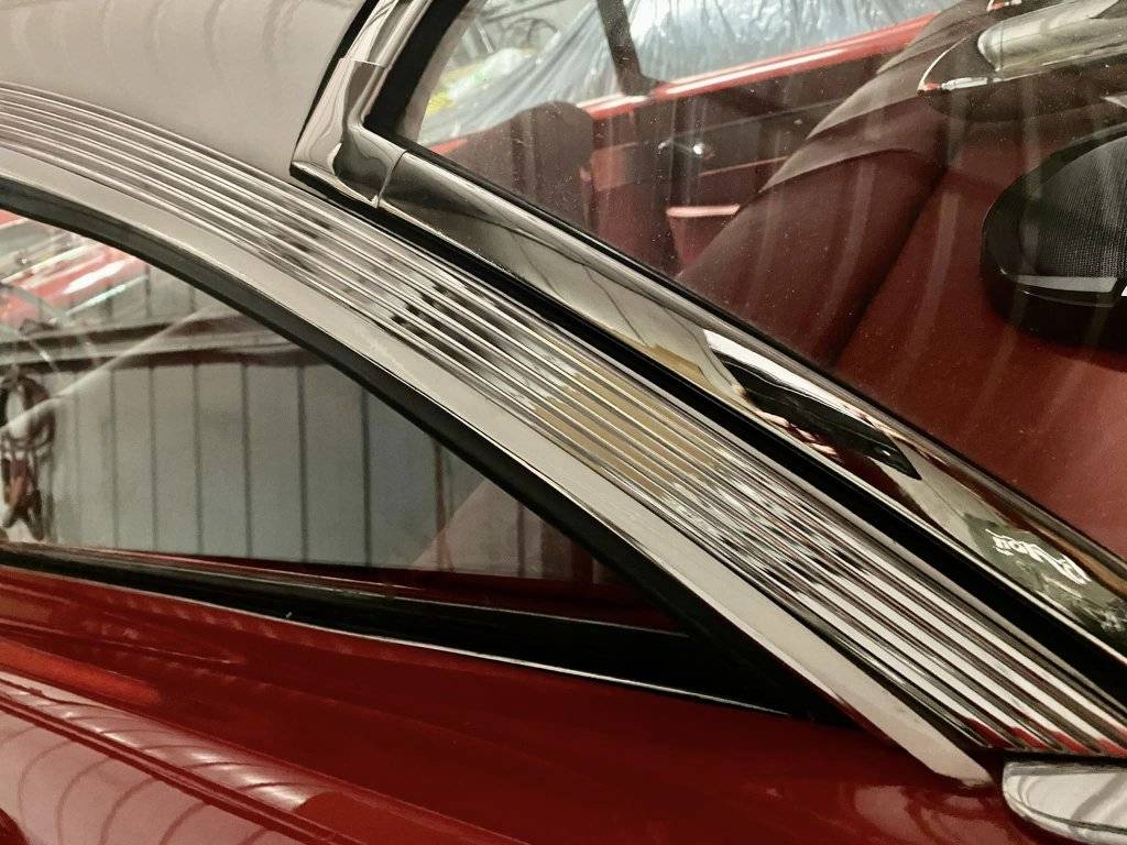

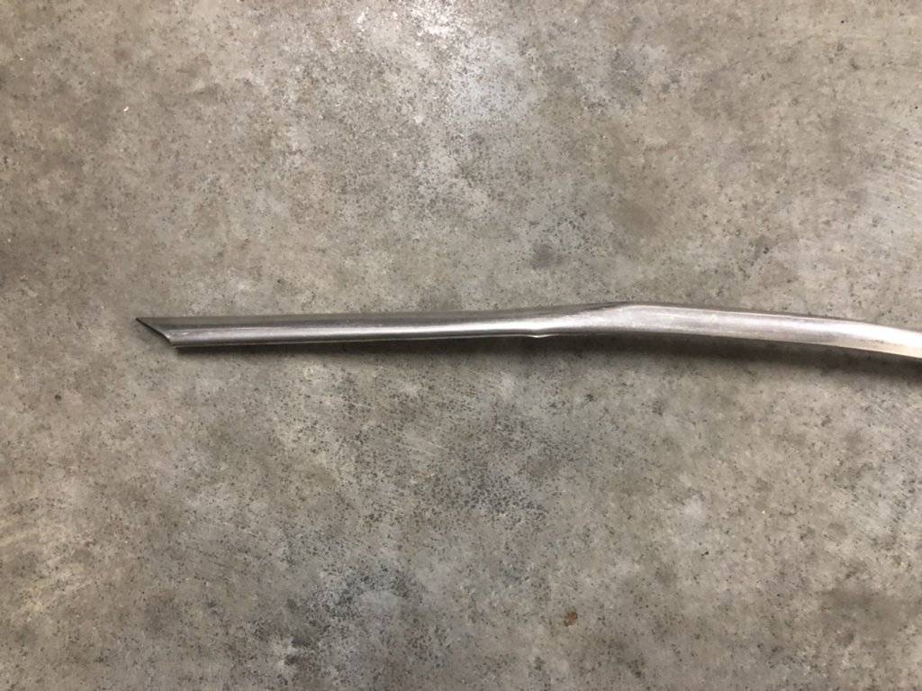

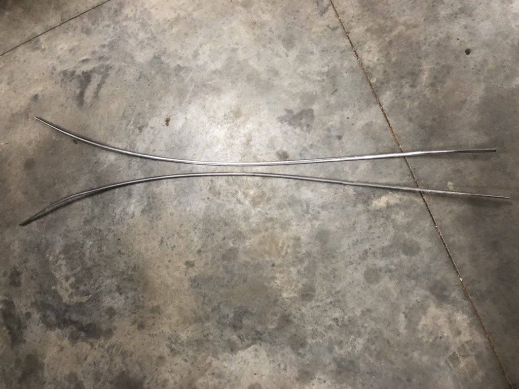

It doesn't look like I can send pics in a private message, so I'll post them here if that's alright. I got to looking at my parts car, and besides the ribbed trim and drip rail trim, it looks like there's some more stainless on the outside of the rubber window channel (see 1st pic).
Pic #1: Parts car showing 3 pieces of stainless

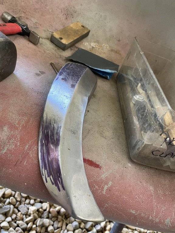

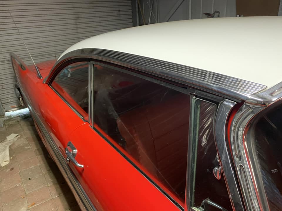

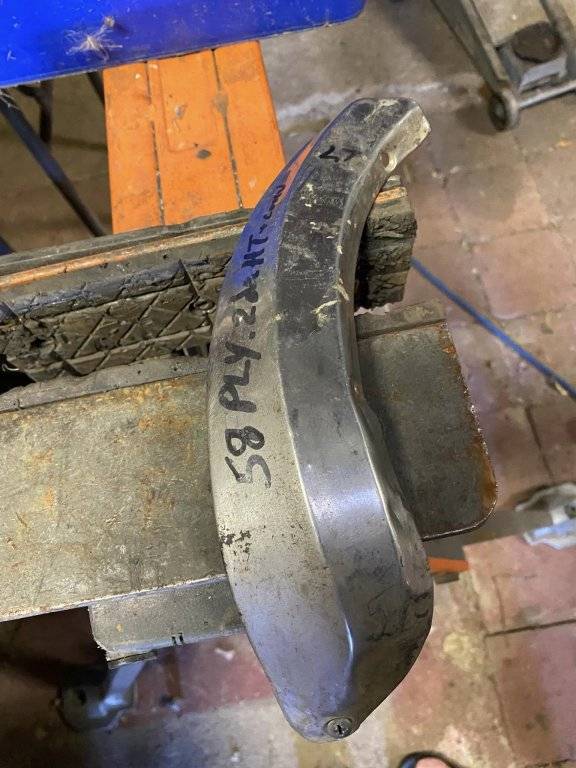

Pic #2: Nick on ribbed trim

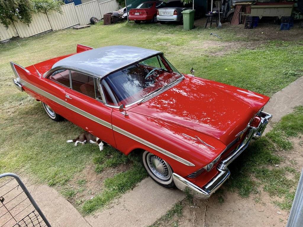

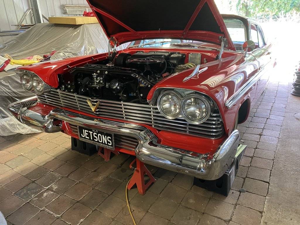

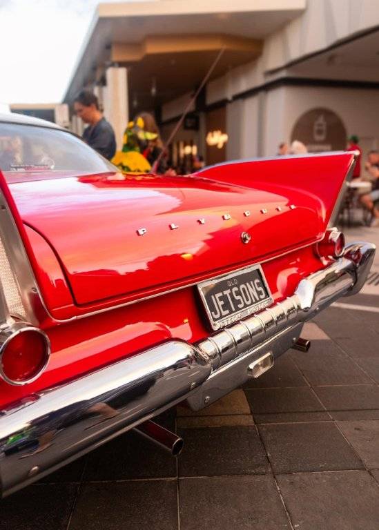

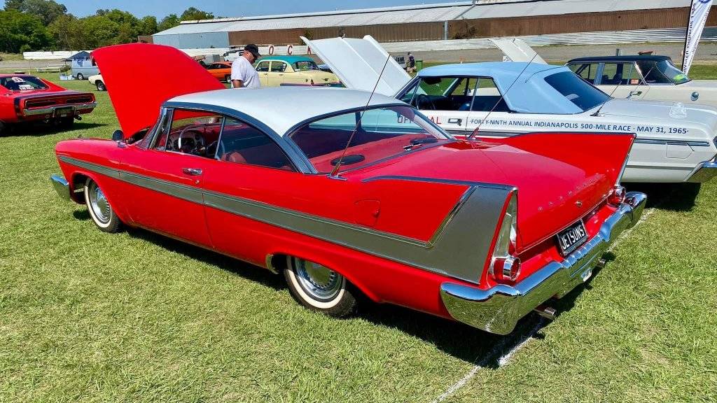

Pic #3: Drip rail/rain gutter trim

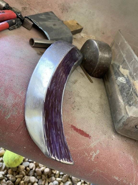

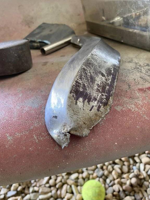

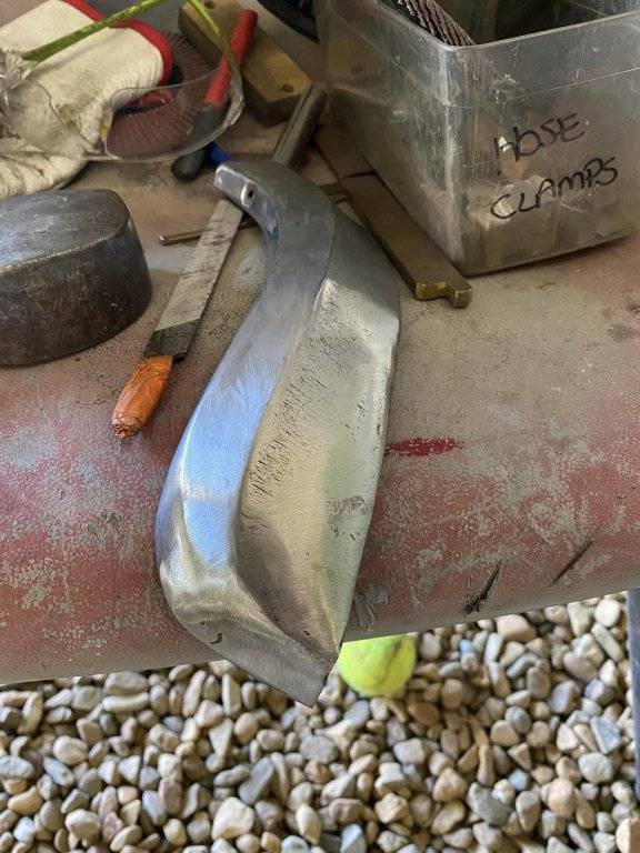

Pic #4: Bend on drip rail trim

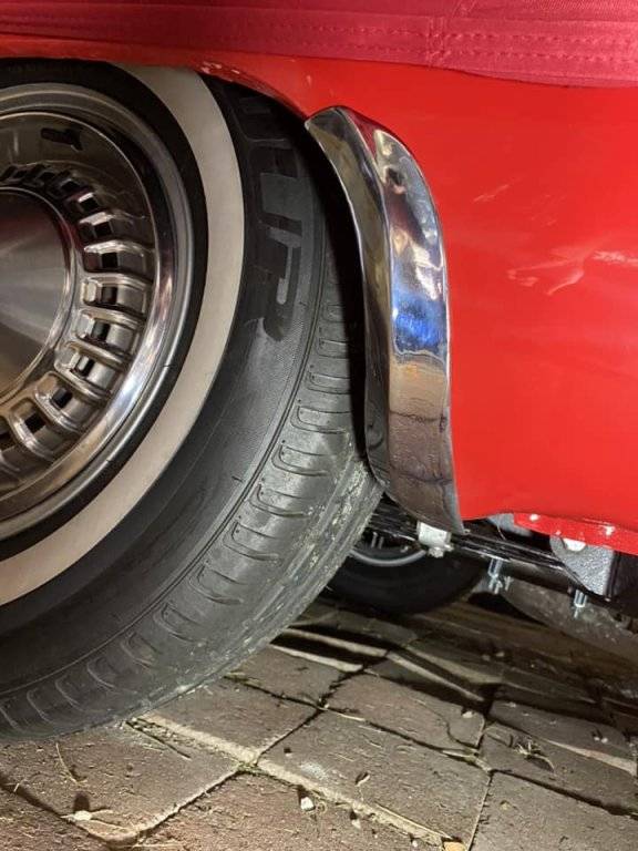

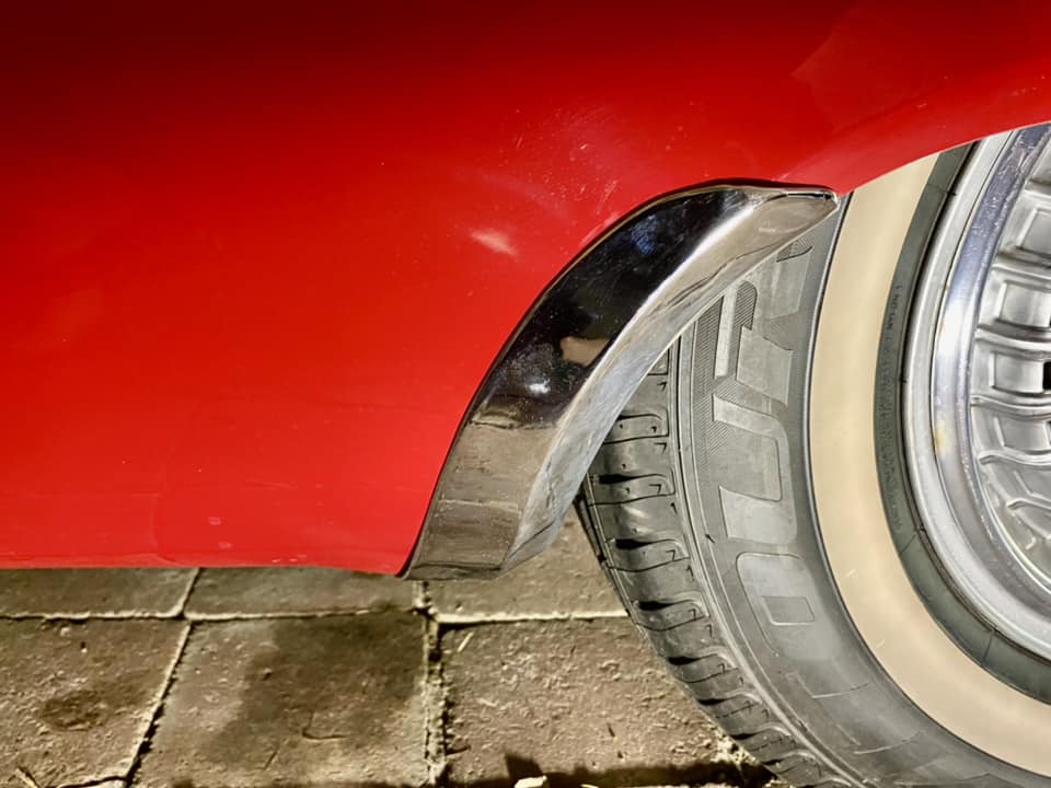

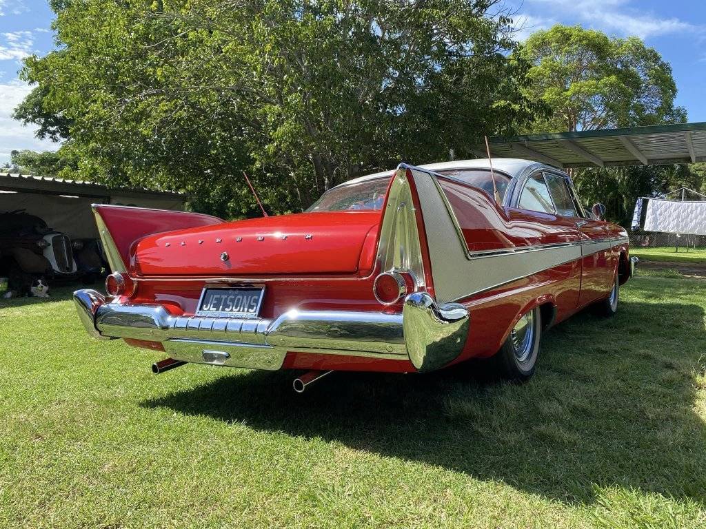

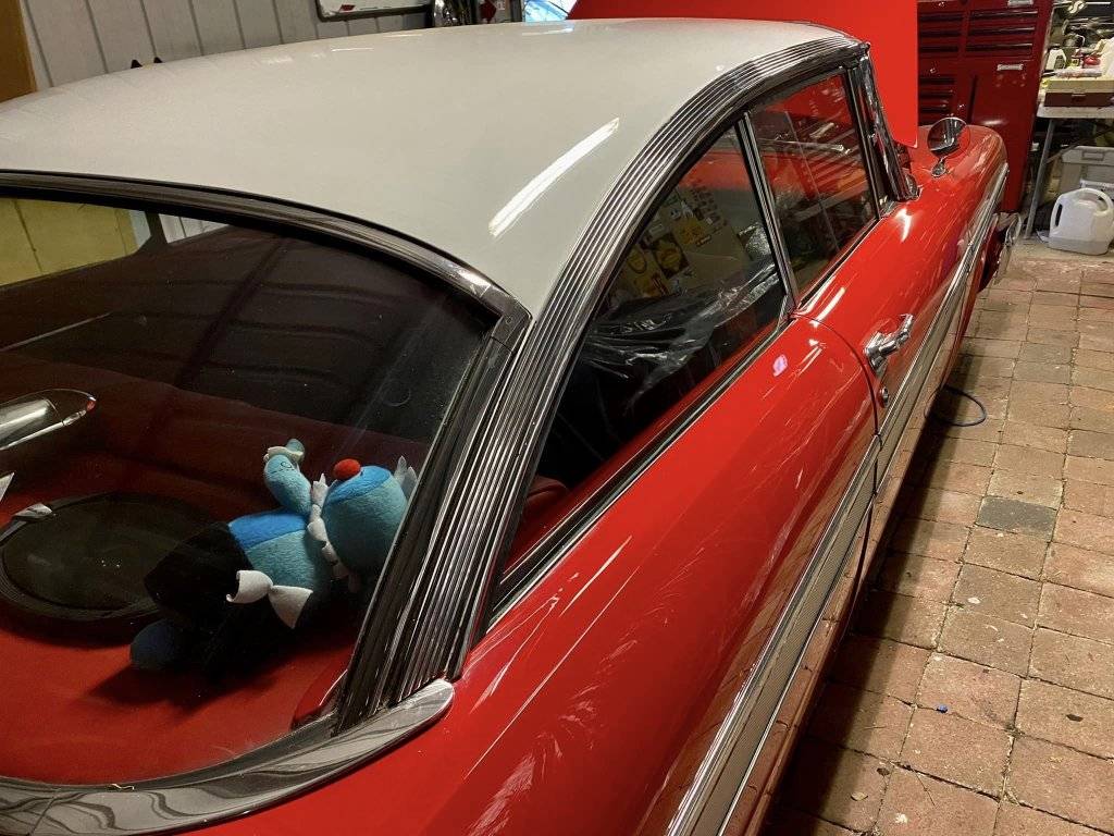

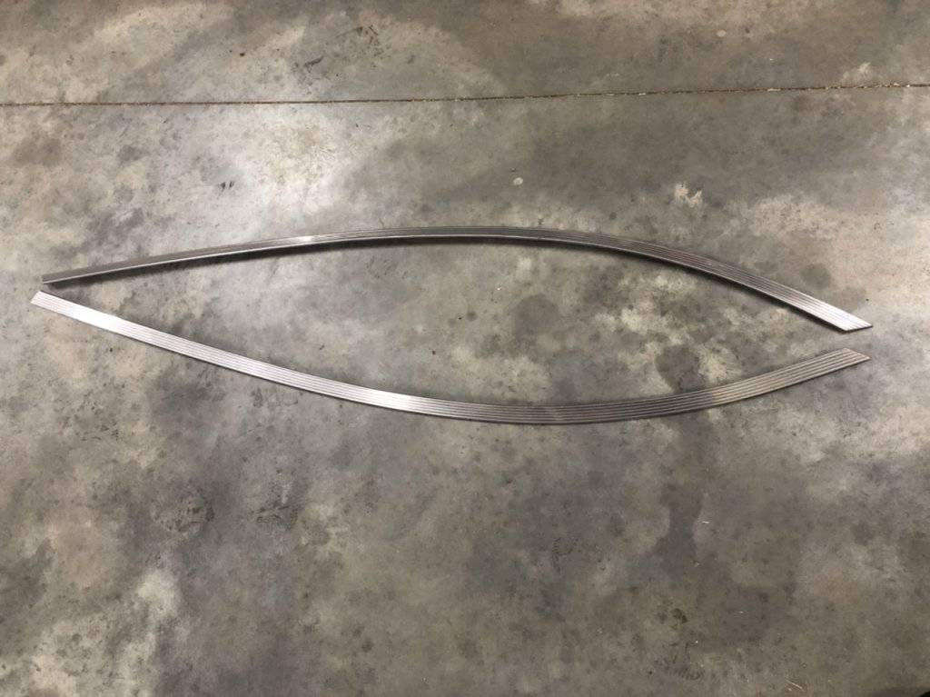

Pic #5: Ribbed trim
Thanks Patrick, the trims arrived today and they are fantastic. Blown away by the help and support of member of this page like yourself that I have received over the last few years.
Trims welded back together and installed

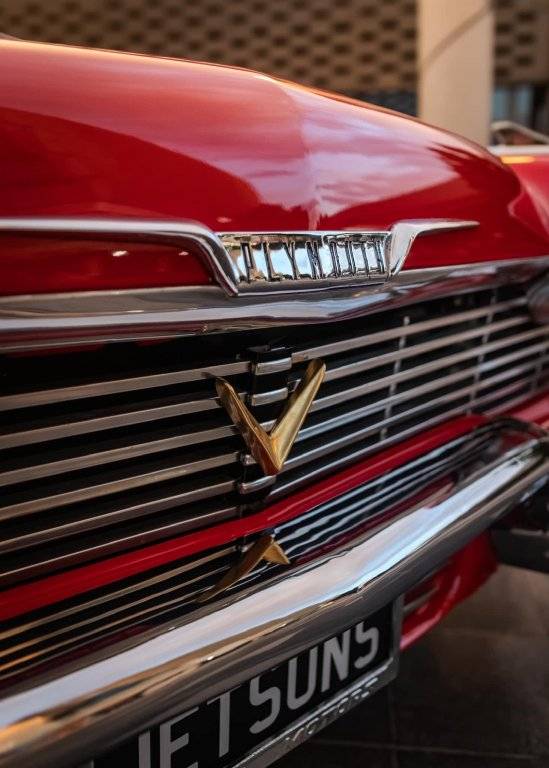

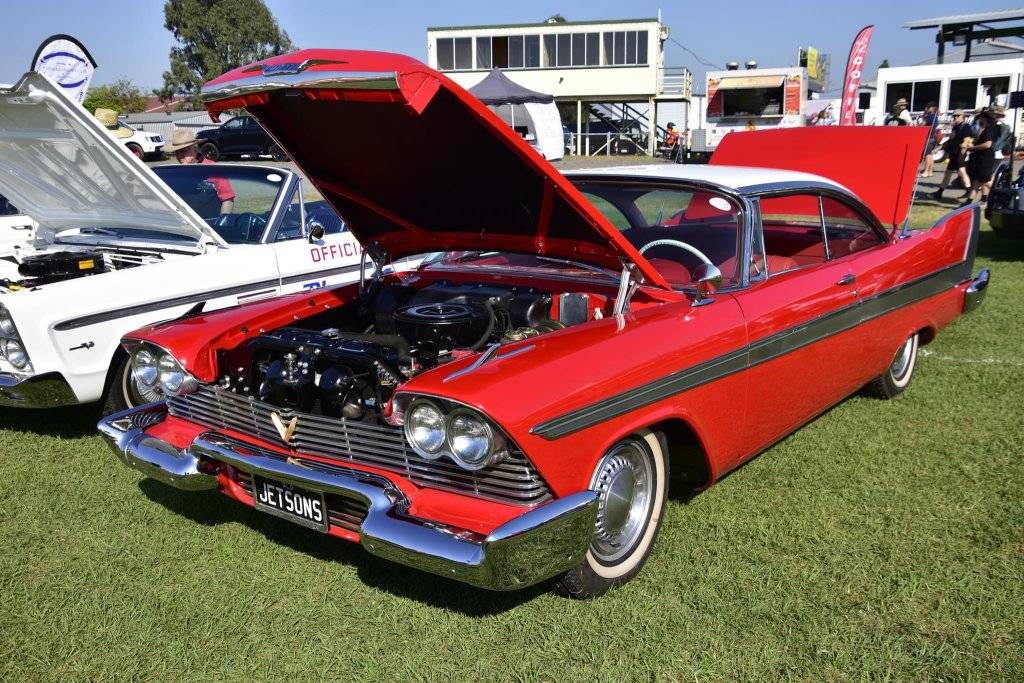

Got the 58 out for a run on the weekend. Replaced the repo grille V with a genuine one. Also added a genuine 57 Fury to the collection. Very rusty but numbers matching car with most of the hard to find bits still on the car.

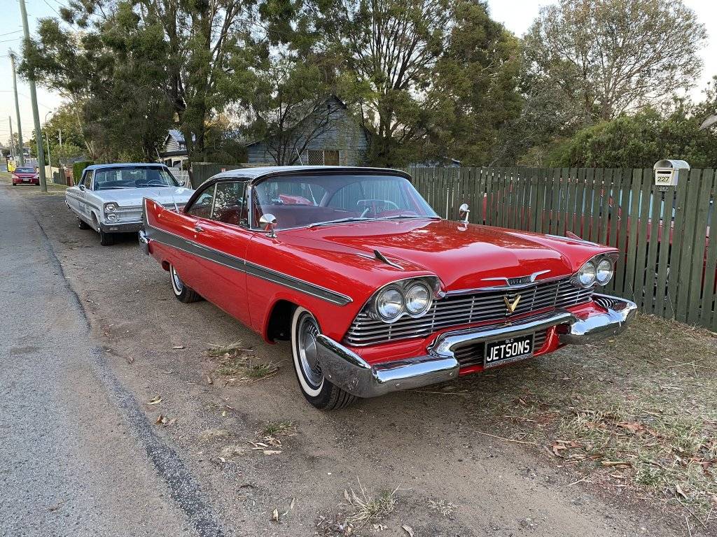

Have been spending a little time driving the 58 over the last few months. Starting to gather bits for a 440 transplant in the new year.
