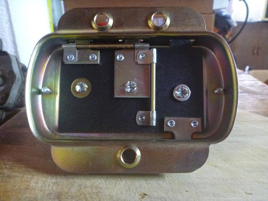

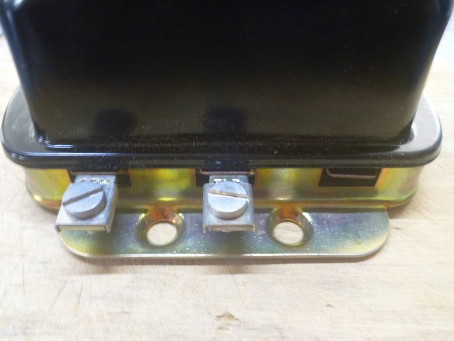

I have bought a new USA made voltage regulator for my 1958 Dodge Custom Royal .
It is slightly different from the old one .

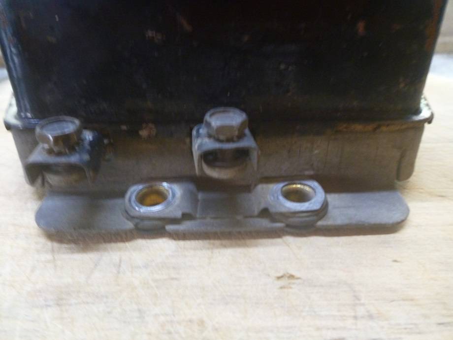

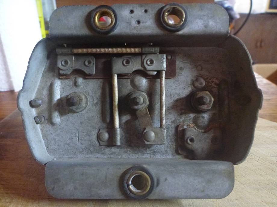

The old one has rubber mounting grommets and a ground strap which is pressed on and can not be removed without wrecking it .
Could i use the new regulator as is ?
Or should i try and add the grommets and some sort of grounding strap ?

The rubber grommets were probably there for vibration issues, which then meant a ground strap was needed to ground the unit to the body. With no grommets, no need for the ground strap. Just make sure the regulator has good clean metal to attach to and the underside of the mounting screw heads are similar clean, I suspect.
Suspecting your new VR is a solid-state electronic regulator rather than the older-style vibrating points style?
