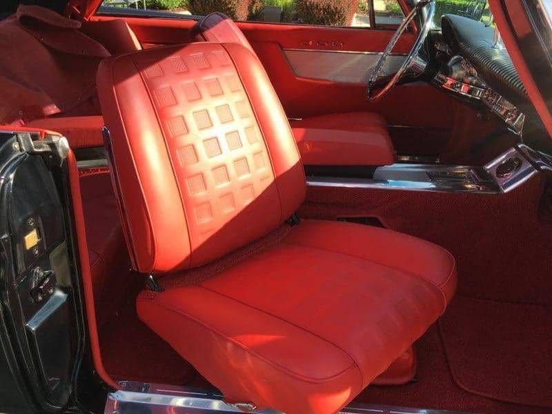

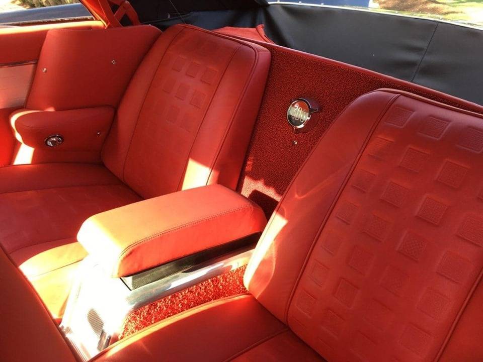

Seems reasonable. It is a beautiful car and hope it runs as well as it looks. I actually like the red Basket weave seats but they are not "correct" in the code "888" interior optional choices. Whoever did it was into fancy but did not know 300G well

That one incorrect item would kick the car out of the nineties as regards scoring level. And I'm sure there is a bunch of other indiscretions to deal with. I think this car is a solid No. 2 car. It would have to be a No. 1 to get anywhere close to justifying the optimistic price.

Drivers seat not factory power as the control is missing in the picture. Vehicle trim plate would confirm special order interior and options. I agree special order interior would not have pattern in leather. I have owned both 60 and 61 300's. #2 convertible price range is $110,000 to $165,000. When viewing photos I ask myself what photos are missing, like the R41HP and build date stamped on the engine pad and Chrysler number stamped on the transmission, both unique to 61 300G.
