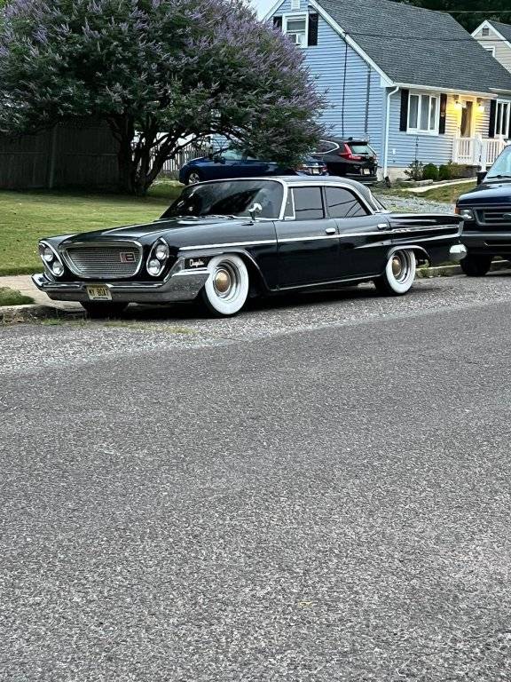

@AngelCalderon — got any photos of the car to share?

BTW, nice car!
